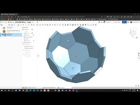

What are the correct assembly constraint commands to join the hexagons and pentagons to complete the truncated icosahedron.  The students will then 3D print their assemblies.
I am failing measurably.
  • john_mcclaryjohn_mcclary Member, Developers Posts: 4,063 PRO
    If the side walls are tapered properly. then fastened should be all you need.

    Soccer Ball | Assembly 1 (onshape.com)
    I had to look up how to calculate a soccer ball. Not much of a polygon person. (had to wiki some maths)
    but here is one way to do it i guess.

  • steve_shubinsteve_shubin Member Posts: 1,118 ✭✭✭✭
    edited January 2021
    https://cad.onshape.com/documents/aa51e464fba34983ad78e2e5/w/4acdfcc9d7f3f9f4b6db37d7/e/25fbc467c63ad85db1f9dd1c
    After seeing @john_mcclary soccer ball, I definitely wanted to incorporate some of his methodology. That was some good stuff that he did. I’m kind of ticked at myself for not thinking of that LOL — come on brain - work
    The way I’m doing it here is going to require an extra assembly tab. So you may want to just bypass the rest of this post
    But if you’re interested in being able to figure out how to make a soccer ball without any calculation, then read on
    There is a second assembly tab used for finding the angle between the different polygons. It was a matter of hinging them to determine where other sides of the polygons would mate together, which in turn, would give the proper angle without calc
    The variable determines the length of one seam in plan view (a straight line) — not an arc along the ball surface. This can be adjusted to change the diameter of the ball. BUT, to get the exact diameter, it’s gonna take a few tries at changing the variable AND updating context in assembly, in order to find the exact diameter you’re looking for — maybe three or four tries. Doesn’t take that long
    Remember — whenever you edit the variable in the Part Studio — that you need to UPDATE CONTEXT in the tab called ANGLE FINDER
    By the way, if you did happen to see the way I did it before, it was convoluted. This way is a lot simpler
    @rod_muirhead943
    Here is a short video showing how to mate the assembly part by part.
    https://www.youtube.com/watch?v=0z_y1pB6-mo
