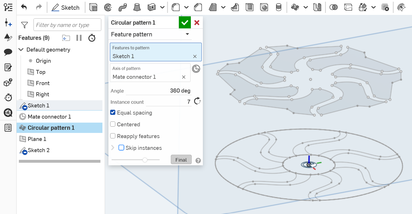

  • eric_pesty
    eric_pesty Member, pcbaevp Posts: 2,923 PRO
    You can also pattern the sketch feature itself. Not the sketch pattern tool, the pattern feature (set to "feature") and picking the sketch containing the spline.

  • martin_kopplow
    martin_kopplow Member Posts: 1,639 PRO
    It works, I've also used that to create brake discs in the past. Many times, creating a solid and then patterning that is the better approach, but there may be times where we don't want that.
    Don't forget this is a feature pattern. Else it won't let you select a sketch.
