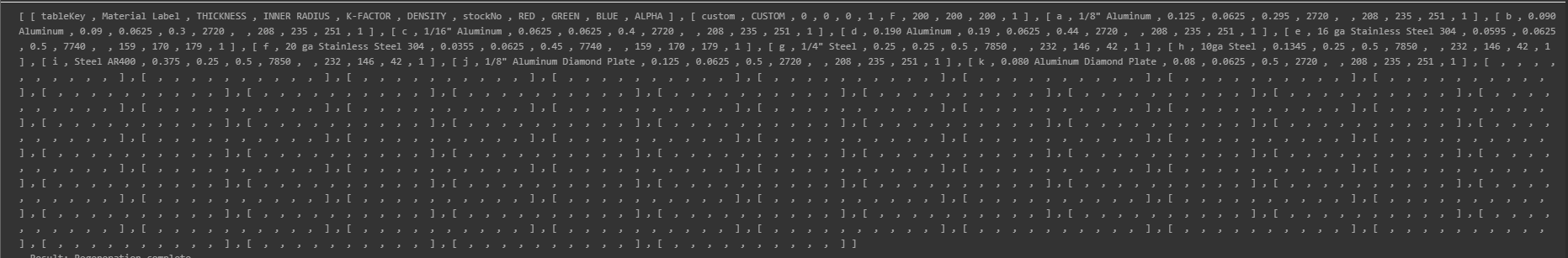

    There is a feature studio called BEND TABLES SCRIPT. At the top there is
    const tables = {
    "DIEV32mmXA88degXR3mmPUNCHV88degXR3mm" : DIEV32mmXA88degXR3mmPUNCHV88degXR3mm::BLOB_DATA.csvData,
    "DIEV32mmXA88degXR8mmPUNCHV88degXR3mm" : DIEV32mmXA88degXR8mmPUNCHV88degXR3mm::BLOB_DATA.csvData,
    "DIEV25mmXA88degXR3mmPUNCHV88degXR3mm" : DIEV25mmXA88degXR3mmPUNCHV88degXR3mm::BLOB_DATA.csvData,
    I'm just loading in the different bend tables there, mainly because The BLOB_DATA stuff looks messy and I don't want to see it in the main code. Basically the feature allows choosing which bottom die/top punch combination is being used for the feature and then the feature picks the matching bend table. This lets the feature use different sheet metal parameters depending on bending setup. Changing the bend tooling v opens and things does affect the bend outcome. And of course, my favorite part, all of this is configurable.

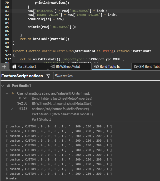

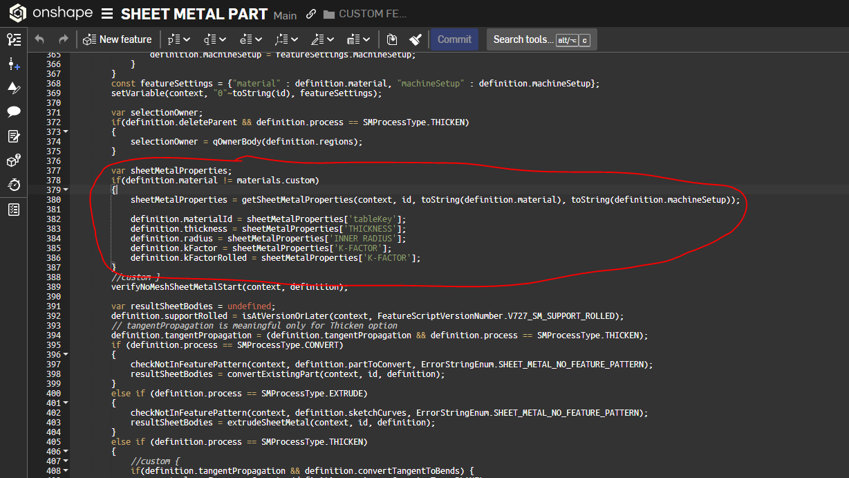

  • mitchell_braun924
    mitchell_braun924 Member Posts: 12 PRO
    @shawn_crocker
    Did you run into the following error when changing units for your Thickness row import?
  • shawn_crocker
    shawn_crocker Member, OS Professional Posts: 1,053 PRO
    Hmm. Iv seen the error before while building the feature but not certain of the context of your example. It looks like you have selected the custom option from the tool enum. I don't use that part of the feature too often so it's possible I did a feature edit at some point and over looked bugging the selection. What do you mean by changing the units?
  • shawn_crocker
    edited March 14
    @mitchell_braun924 I took a closer look. The fact that your println() is actually returning the values created from the bend tables exported function, while having the custom material option selected points toward you having potentially allowed the feature to attempt to process a material selection from the table. When the custom option is selected, the feature is supposed to be skipping over the part that pulls the correct material data and assigns it to the standard definition map. When custom is selected, it just used the values already in the map from the users input. See the circled code from the main sheet metal feature. That circled code shouldn't be running when the custom option is selected. If your println() are pushing information to the console when custom is selected, the getSheetMetalProperties() function is being run when it isn't needed. The specific error you are seeing I'm less certain about but it might be because the function is attempting to do math and use standard library functions with values that it isn't expecting. The thickness values and things allocated to the custom row of the table are set to 0 and I think other library sheet metal functions might not be feeling happy about receiving 0 as there input. To be honest, I'm not sure why I keep that row called custom in the table as it seems like it is never being used. I think it is left over from a time when I was trying to overcome some other problem and now I have just left it simply because I'm not sure if its needed or not.
    Actually, I think the custom row is left over garbage from a time I thought I was actually going to be able to find a way to populate an enum with the data in the cvs.
