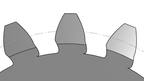

    I discovered a strange bug that appears to be in the new standard library.
    One of the (I thought) harmless changes I added was bumping the library versions used from 1576 to 2641 so I could use the transformUV.fs functions that didn't exist in 1576. This appears to introduce a strange warping of the gear teeth in circular patterns with varying clocking angles.
    When using my Spur Gear in a circular pattern where the clocking angle changes with each instance, you start to get strange warping like this;
    This is meant to be a gear with no chamfers.
    I attempted to debug what was happening by editing the featurescript to not delete all the cruft sketches etc so I could see what they looked like. For the first instance with clocking angle of 45deg I got this, which looks how I expected the tooth-sketch to look;
    and for the third instance rotated 240deg around the circular pattern with a clocking angle of 3*45=135deg I got this;
    The tooth area is roughly in the right position around the circle, but it's got the strange distortions. The points used for the spline tooth-sides are not even on the spline! They appear to be in a position that includes the correct circular pattern rotation but not the changed clocking angle.
    Rolling back to the 1576 libraries (I don't use the `transformUV.fs` feature any more any way) this strange warping goes away, and the tooth sketch is in the right place and looks correct:
    I guess I'm rolling back to the old libraries…

    I did a bit of a manual bisection on versions and 2180 is the last version where this worked OK. At the next version 2207 things started to go screwy, but not in the same way I observed with 2641. Instead it just failed to do the circular pattern, complaining "CANNOT_RESOLVE_ENTITIES".
    It does profile a tiny bit faster with 2180 than with 1576, so I guess I'll use 2180.
