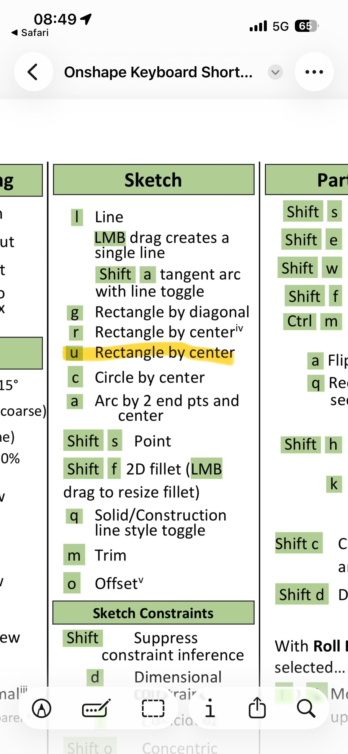

Keyboard shortcuts are an incredibly valuable feature and productivity aid while using Onshape.
Several years ago I made a Quick Reference card based on the on-screen shortcuts help ("?"). I have been religiously been maintaining this document over the years and would like to share it with the greater user community as a thank you for all the great support that exists in the User Forum.
It is organized differently than the built-in on screen shortcut help to improve its usability. It has been augmented to include useful information about specific shortcuts and contains more detail about 3-button mouse functionality.
The reference card is 2-sided and is designed to print on a 8.5x11 card stock.  Following are preview images of the front and back.
                                                                        --- Front ---
                                                                    --- Back ---
A printable PDF of the document can be found here: https://1drv.ms/b/s!AuMUtTIiNawOgqVOsNY6CvJoA4mUjA?e=SYCbW1
Improvement suggestions welcome.
My intent to maintain this reference card as Onshape is updated.  Note: If you post a comment to this post you will automatically be informed when I create a new version of the reference card.

    Reference card updated to include recent shortcuts added in 2023-04-12 update...
    New keyboard shortcut for Revolve (SHIFT + w)
    New keyboard shortcut for Hide/show sketches (SHIFT + h)
    New keyboard shortcut for sketch point (SHIFT + s)
    New sketch shortcut from line to tangent arc (hover over endpoint to toggle or SHIFT + a
    Plus keyboard shortcut for 2D sketch curve analysis display (SHIFT + c)
    Printable PDF of the document can be found here: https://1drv.ms/b/s!AuMUtTIiNawOhKoag49Pc7yx2jiDDg?e=UEyfDq
    Note: Found it impossible to fit the new shortcuts into existing reference card framework. Had to convert some of the shortcut descriptions to endnotes which appear on 2nd page (back of reference card).
