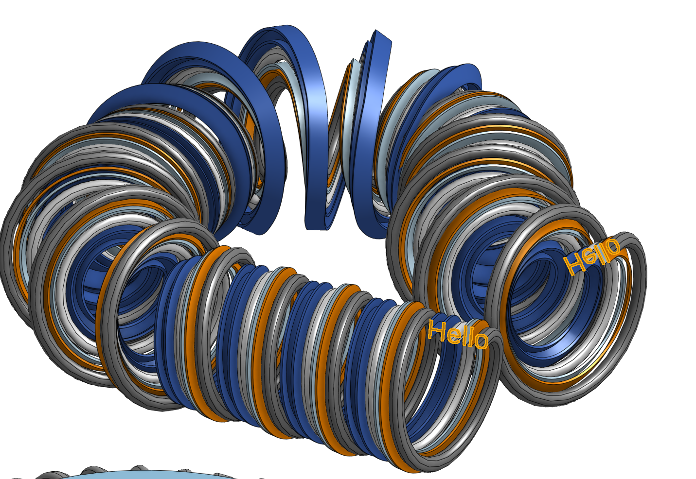

Hello. Sorry if my question is trivial, but I'm starting the design using OneShape (earlier I had used other software).
I would like to ask, how could I draw a coil (inductor) on shapes like a toroid or a shape on with I would like to design an transformer?
https://cad.onshape.com/documents/59007ff281e43510ea3797a2/w/a6cb15bca8f1b2bf6e312ccd/e/8695694c2f658a05d1fb7da2

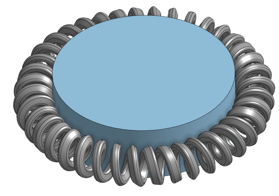

The most close of what I need is the drawing on the "part1" tab, second from the top left with the dentisity of the first top left
Then in your drawing, create a circle to spiral around and set up your parameters.
When creating a 3d shape around the coil, you can't sweep and be self intersecting.
so you have to do a few steps to split up the ends
There is probably a cleaner way to do this, but the Idea is there so you can work your way around it.
Coil | Part Studio 1 (onshape.com)
is there any way to make it so I can make a custom profile for the turn like say a rounded elongated rectangle
You can make whatever shape you want, it's just a sweep
