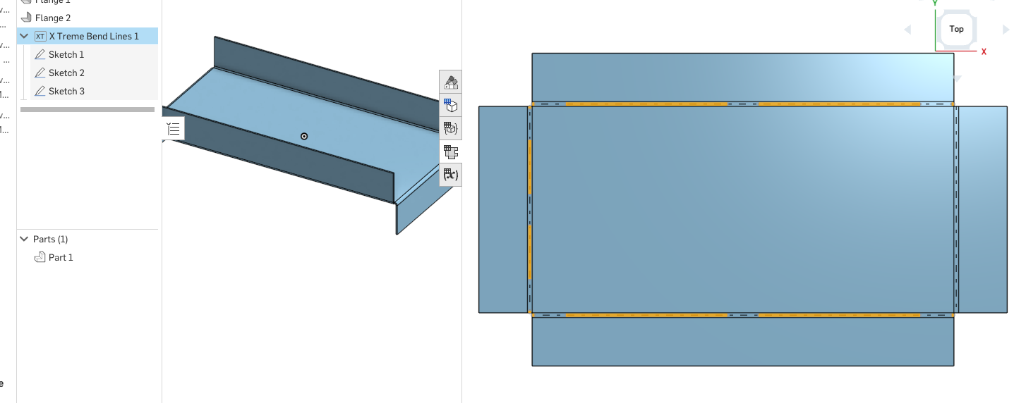

    It was nice to meet you in person @Caden_Armstrong and talk about this, but I figured I'd update the rest of this thread too with my workflow in case it helps anyone else prototyping bent sheet metal parts. My local version "X Treme Bend Lines" (i.e. [XT] for use with our xTool laser cutter) helps you export a DXF to get crisp and precisely located bends.

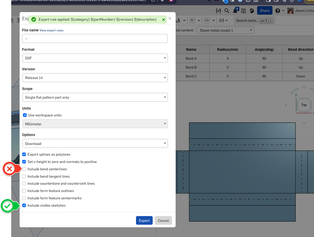

    I ended up tweaking the feature to create only sketches on the flat patten and not actually modify any sheet metal geometry. Then when you export the DXF from the flat pattern view and make sure your settings are correct (Fig. 2), you get a file ready for the laser cutter. The nice thing about this method is that is streamlines in-house prototyping while also not effecting the STEP or PDF exports that go to production suppliers— it just creates 1 sketch per bend line under that feature.
    The 1mm long bend markers on each end are also inset from the outline by 0.1mm to ensure that the laser cutter cuts your bend lines first and then does the outline. I've also found that these 1mm long laser kerf width marks make for even more precise bend locators than using the > and < style cuts.
