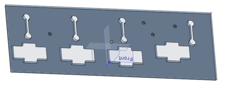

Hi
I Am trying to copy/paste a group of sketch entities and then position the pasted entities in their new location.
I paste the group:
And then I am trying to coincide one of the points to a reference line so the new entities will be centered.
When I add the new constraint only one point moves to the new location, what I need is for the entire set of entities to reposition.
Is there a way of doing what I'm trying to do? What is the right way of doing that?
Thanks
Erez

    I think it is an issue of not properly constraining the sketch entities. Make sure that your original sketch is completely constrained (ideally all lines and points turn black) then copy and paste. Yes, it is possible to do what you are trying.
  • eric_pesty
    You can also select the group of things you want to move without fully constraining them using the transform command, this will let you move them all at once (but the result won't be "parametric", ie the position will not update later on). You can move the manipulator origin to existing reference point (you may need to add one if you dont' already have it) and when you drag this point will snap to other geometry.

    So, the answer here is, "You can't do it." I also need to group a set of sketch entries for similar reasons as the original questions.
    The sketch was a copy and paste from another document, but I want to parametrically attach this sketch to a reference of the part I've added it to.
    The best I can do is fix all the entries, and use transform to move them. That gets it in the right place but there are no parametic updates when the reference point moves. It gives a constraint error instead. At least I know it's an issue, but then must remember later what it was attached to etc.
    I can add 20 dimensions to the sketch to tie all the unconstrained entities together, but that's a pain worse than as justified.
    What I want is a group command like in assemblies that lock the items to a group relative to each other but leaves the group still unconstrained. Then that group can be transformed to the correct location, and then hopefully move as the reference point moves.
    Am I correct that this sort of sketch entity group feature just doesn't exist?

    There's no built in group function like in other systems, but there are many ways to work around it. This is an older thread.
    We can now use sketches like parts in assemblies if that helps. This can be good for 2D or even 3D motion studies.
    Depending on what your sketch looks like you can also turn it into a surface in the part studio and then use the part transform feature to move, rotate or scale the surface. This can then be thickened or turned back into a sketch.
    If the sketch "group"/"block" is something that you're going to use over and over, consider putting it in another part studio or even a different document and deriving it into other part studios to use it. In that case I would consider a surface or even part model approach to keep the derived geometry as a thing that can be placed and scaled however you want. I've done this for logos.

    Like eric_pesty said - the transform command performs this function on sketch entities just fine, as is.

    Maybe I misunderstood the original question, but I'll try a little more detailed explanation - (this is for a one time move, at the sketch level - and without parametric references)
    1. insert or draw sketch elements (that will later be moved)
    2. pick or box select the above elements
    3. click "transform command"
    4. "click, drag & drop" tiny circle at the vertex of co-ordinate symbol to your choice of "start from" points (it will snap to new location)
    5. "click, drag & drop" the square symbol near the vertex of the co-ordinate symbol to the area that you want to attach the coincident constraint (this will snap to and create the coincident constraint at the little circle in #4 above). All selected geometry will move together and will snap to other existing geometry anywhere you want it to.
    6. If not already, you should fully constrain the geometry at this point.
    This method will easily move the items in the original post, in a predictable manner,
    Go to "transform sketch" in the help section and do a deep dive into what this command will do (they may do a better job of explaining this).
    This particular command is one that I overlooked and underestimated at first. It is quite powerful when used correctly.
    Hope this helps
