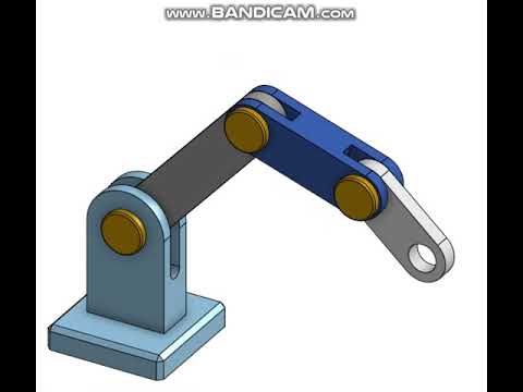

Dear friends
I succeed to create an animation of more than 2 arms but they are moving simultaneously (as you can see in the movie).
Now I want to create animation where each step starts only after the previous step reaches its end point.
I'll appreciate if you can help me
Thanks
Amir Livneh
https://youtu.be/qFPYtEFuIWM
  • john_mcclaryjohn_mcclary Member, Developers Posts: 4,035 PRO
    The only way I know how to have multiple animations is to create a timeline of parts.
    Where the length of the part represents time, and the height of the part represents distance.
    You will then need to connect the sketch with a curve, such as a spline or sketch curve so that the timeline parts are tangent.
    Then create a 'cursor' part that rides tangent on the timeline and create a rack and pinion relation between the cursor's elevation, and the rotation of each joint.
    Now you just. need to repeat that for each joint.
    Then animate them by animating the slider mate that runs along the length of the time line parts.
    Animation | Assembly (onshape.com)
    You can change how fast each animation is for each joint by modifying or adding more curves to each of the sketches 'j1' 'j2' or 'j3'
    In the example document, I have the home position set to vertical.
    So, if we add a curve that ends 0.25" below the top plane, then that represents a rotation of 90º clockwise on the joint. (0.25 x 360º = 90º)
    I then set a length of 1" along the time axis to set how fast I want that to animate, which is relative to the speed of the overall speed of the animation.
    The 0.25" on the top here, was just when I wanted the next animation to begin. In this case, I have 25% of the J2 animation beginning just before the J1 animation completes.
