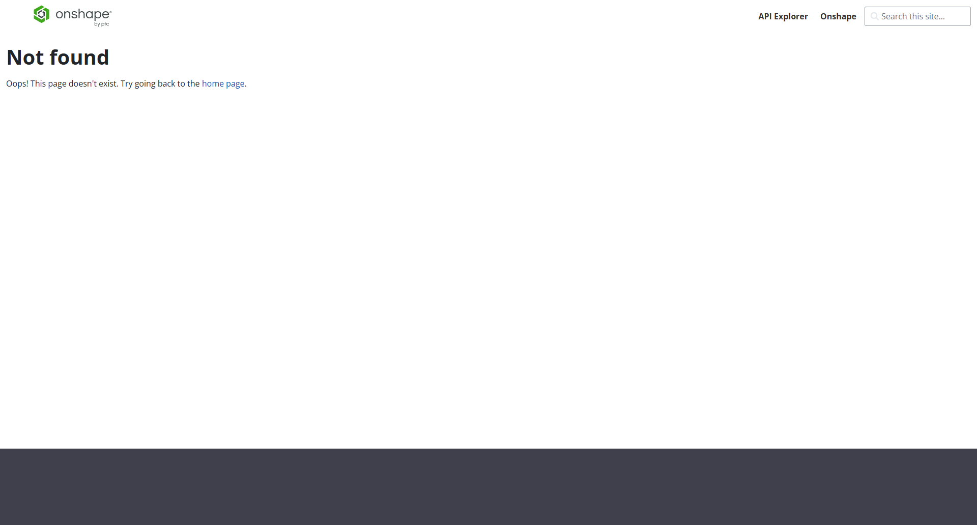

@joshtargo thanks for letting us know that link is broken! I'll make sure it gets fixed. The new link to Extensions documentation is here: and there's a Hello World here: .
