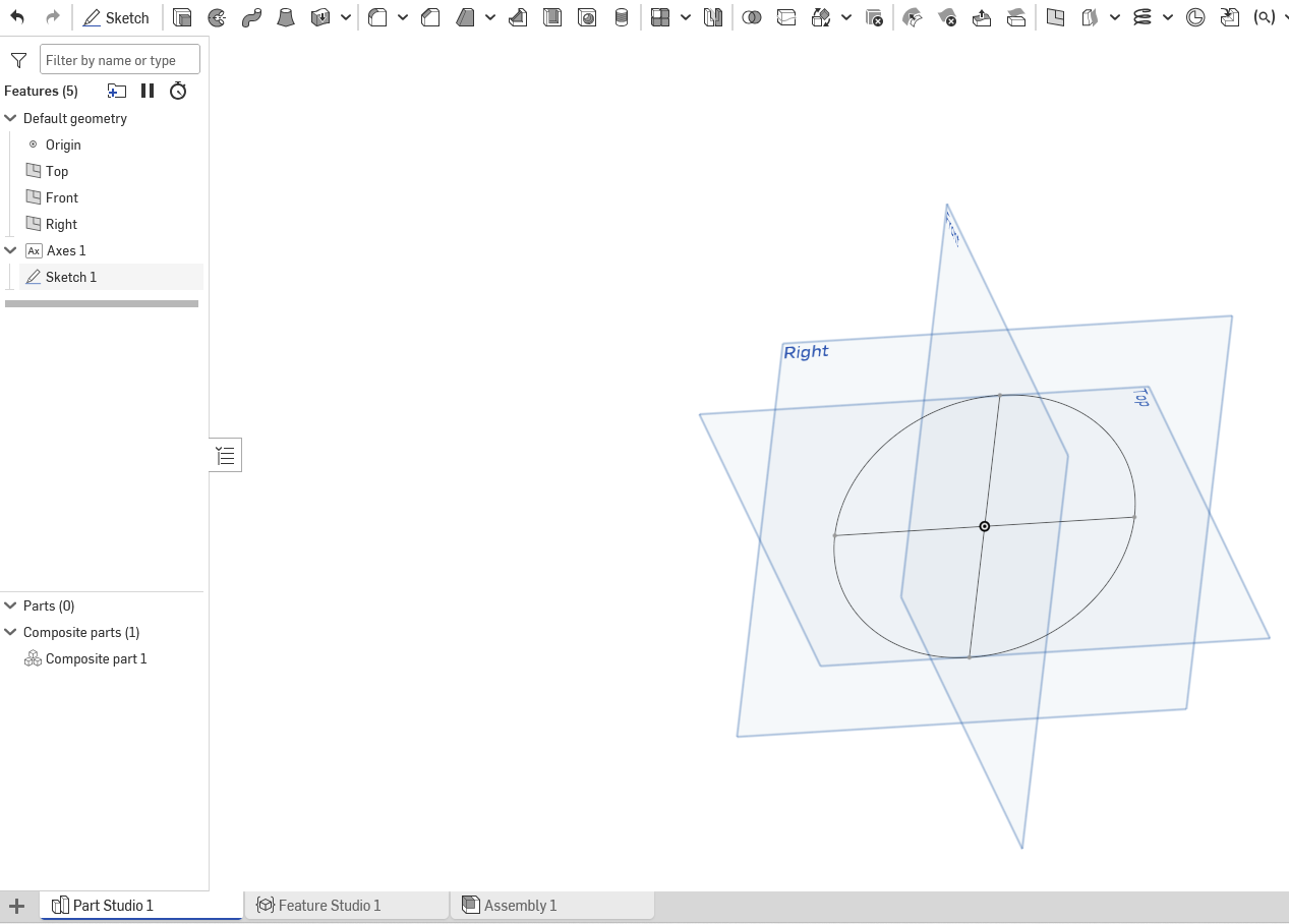

Aloha All,
I am trying to write a FS that generates a sketch that is accessible from within Assemblies. What I am seeing is that a feature is generated with the sketch I have devised but this "sketch" isn't available to insert into an Assembly. Is there a way to create a sketch in FS that shows up as an actual sketch instead of a feature?
The first feature in the following image shows the sketch as generated by FS and the second feature in the list is a vanilla sketch created with the sketch button. Only the latter is available to insert into an Assembly.
I am new to FS but not new at programming. My code is as follows:

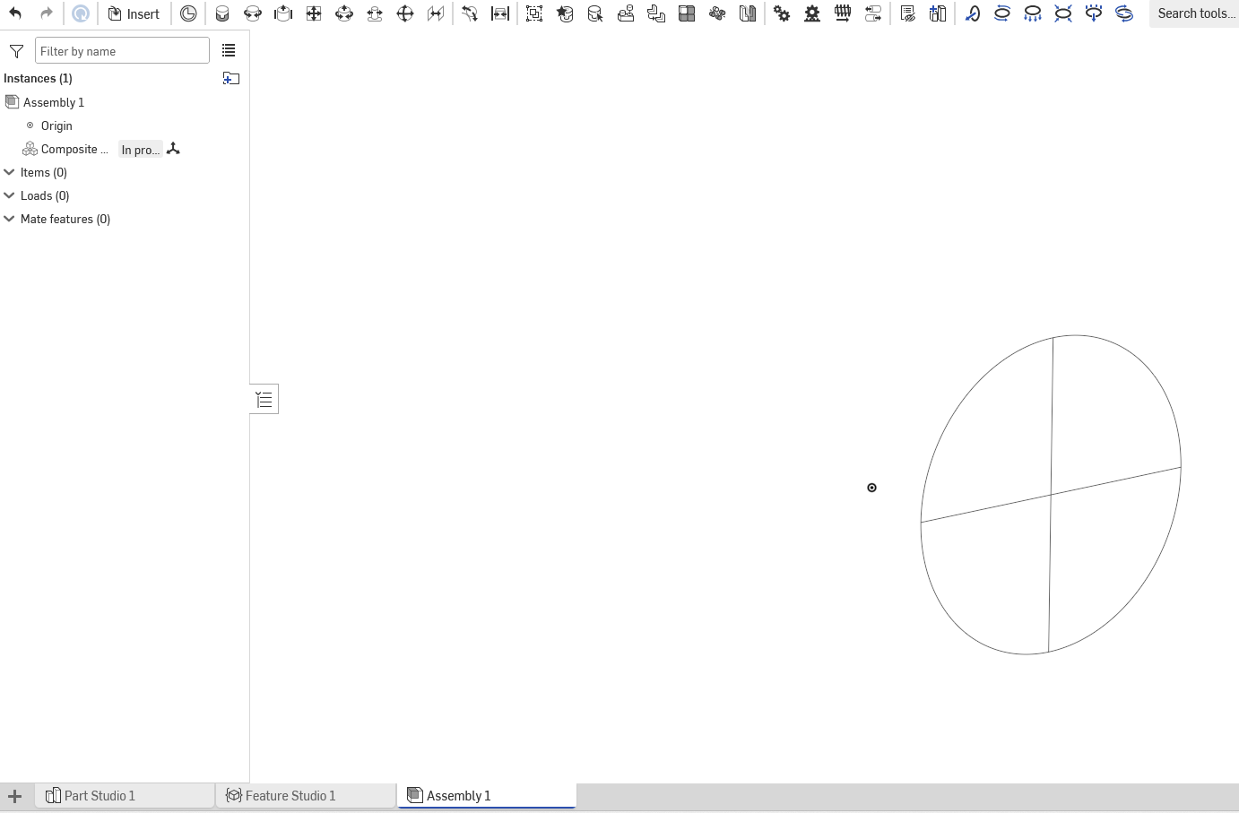

    I just checked to confirm that FS generated sketch edges can be included in composite parts. So I threw an extra few lines onto your script to wrap the sketch into a new composite part. This part can be put into an assembly.
    EDIT: forgot to add the changed code:

            // Composite parts can't contain sketch bodies, so copy each sketch edge
            // into a standalone wire body first. Edges are extracted one at a time
            // because opExtractWires fails when edges cross or 3+ meet at a point
            // (the lines cross at the center and touch the circle at their ends).
            for (var entityId in ["circle1", "line1", "line2"])
                opExtractWires(context, id + "wires" + entityId, {
                            "edges" : sketchEntityQuery(id + "sketch1", EntityType.EDGE, entityId)
            opCreateCompositePart(context, id + "compositePart", {
                        "bodies" : qCreatedBy(id + "wires", EntityType.BODY),
                        "closed" : true
