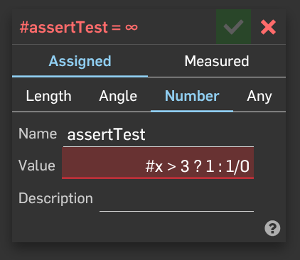

  • kyle_altendorf
    kyle_altendorf Member Posts: 74 ✭✭
    #x > 3 ? 1 : 1/0 in a number variable definition seems to work in terms of it being invalid and creating a failed entry in the feature tree at least. for cases where you really do want a failure instead of just more detailed logic to drive a dimension. it just has to be passing when you create it or the green check is grayed out.
