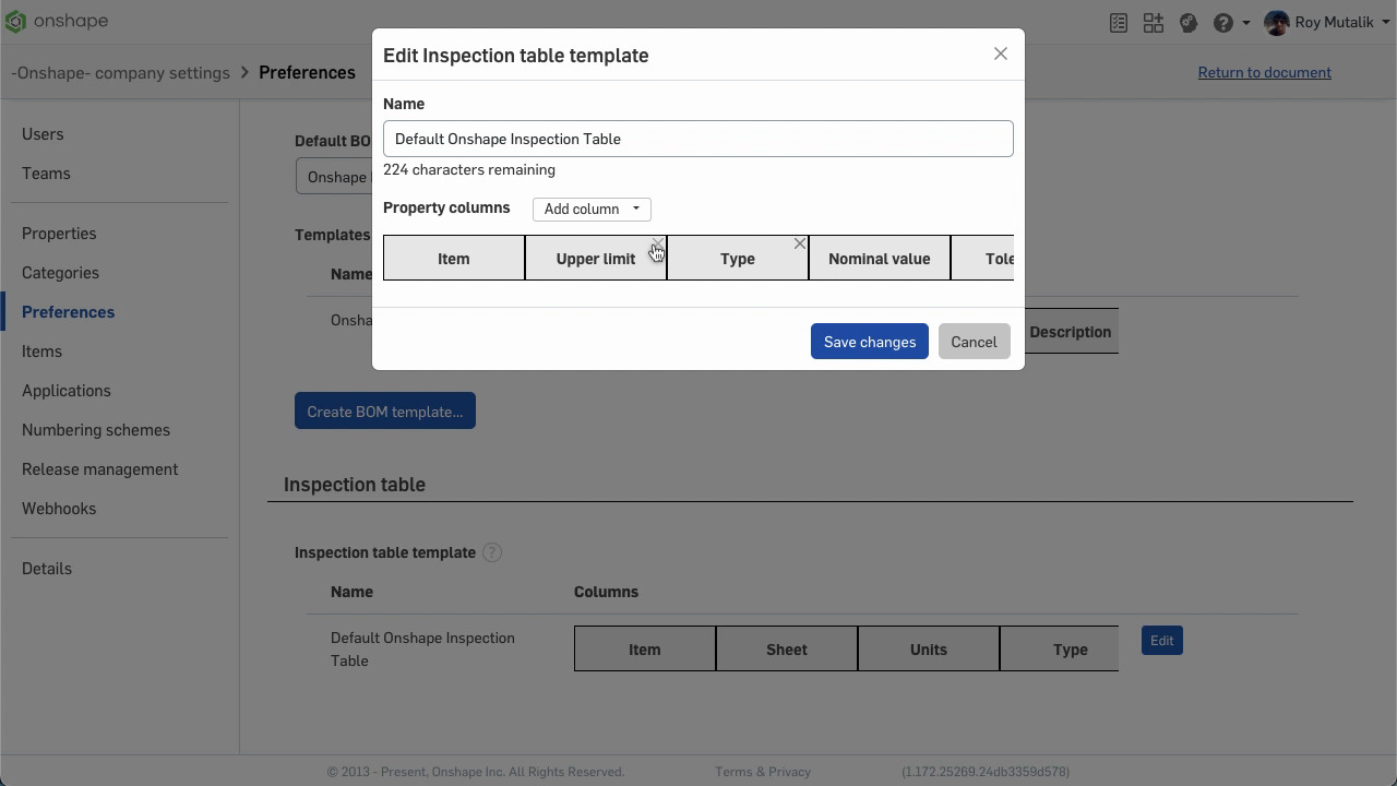

  • Kyle_BurtKyle_Burt Member Posts: 11 PRO
    Is there any way to not include the new Tolerance column to the Inspection table?  For our company's setup, it's redundant information since the upper & lower limits are already displayed.  It's now just taking up precious drawing real estate.
  • PeteYodisPeteYodis Moderator, Onshape Employees Posts: 578 image
    @Kyle_Burt There will be company level controls for inspection table columns, but not yet.
    @Kyle_Burt Take a look now:
