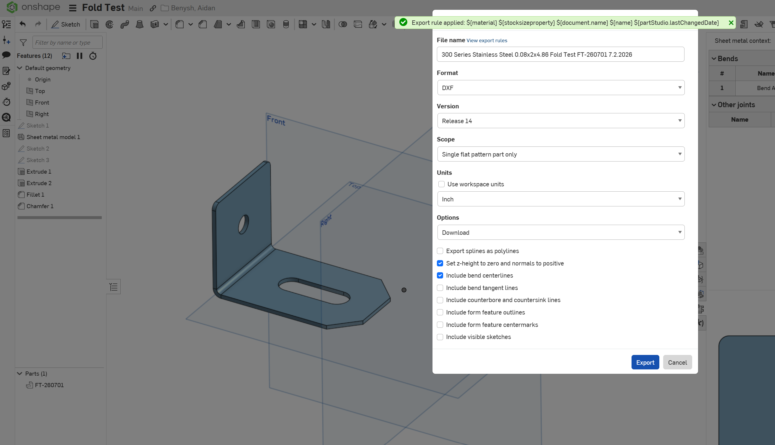

    This code is probably not optimal and the debugging methods are basic but it appears to work.
    This outputs a computed property that is "computeFlatPatternSize" this string gets hidden away in the document.

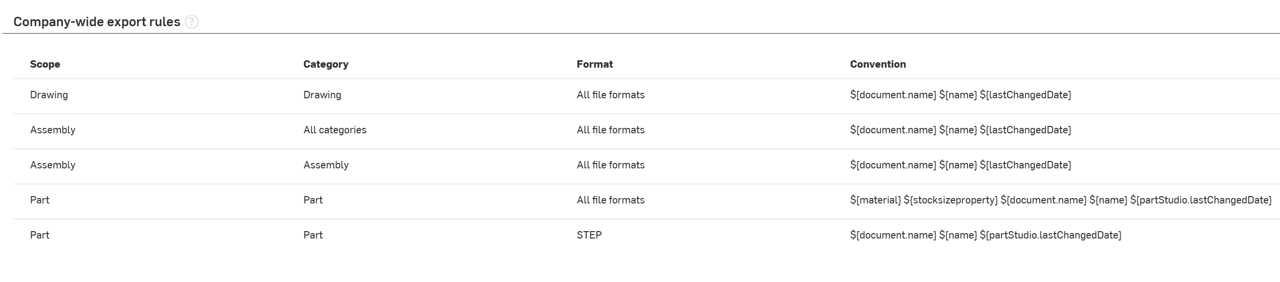

    For the next step we create a custom property in the company settings. I called this property "stockSizeProperty" since it already existed from the previous stop-gap solution. The "stockSizeProperty" then can become a computed part property referencing a working version of the "computeFlatPatternSize" property. Do this while selecting the categories Part and Part Studio to be Active with scope of Part and Part Studio respectively.
    Finally, under preferences we can change export rules for the file types as necessary using the "stockSizeProperty" in the proper naming convention. I partnered this with a few other properties to further characterize the files. See the image below.
    These do seem to have a 'stack' where the order does matter as to how they are applied. [This seems to be trial and error and I don't know how that works] You can see this on part studios where the regeneration time is long, where upon export the original file name will appear then change very quickly once the export rule is applied by the system.
    Once these things are complete the result can be seen in the image below.
