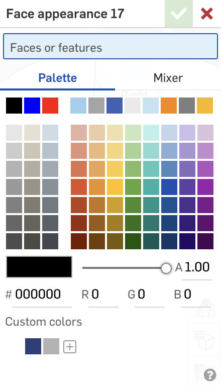

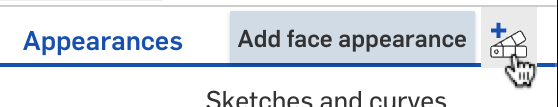

    I found that once a derived face has a custom appearance, the right-click menu changes from "Add appearance to face" to "Edit face appearance". Once this happens, you cannot use the right-click menu to change these faces separately.
    But the appearance side panel has a button that will open a new dialog to let you add a new appearance to a derived face! This solves the problem, though it was hard to find.
