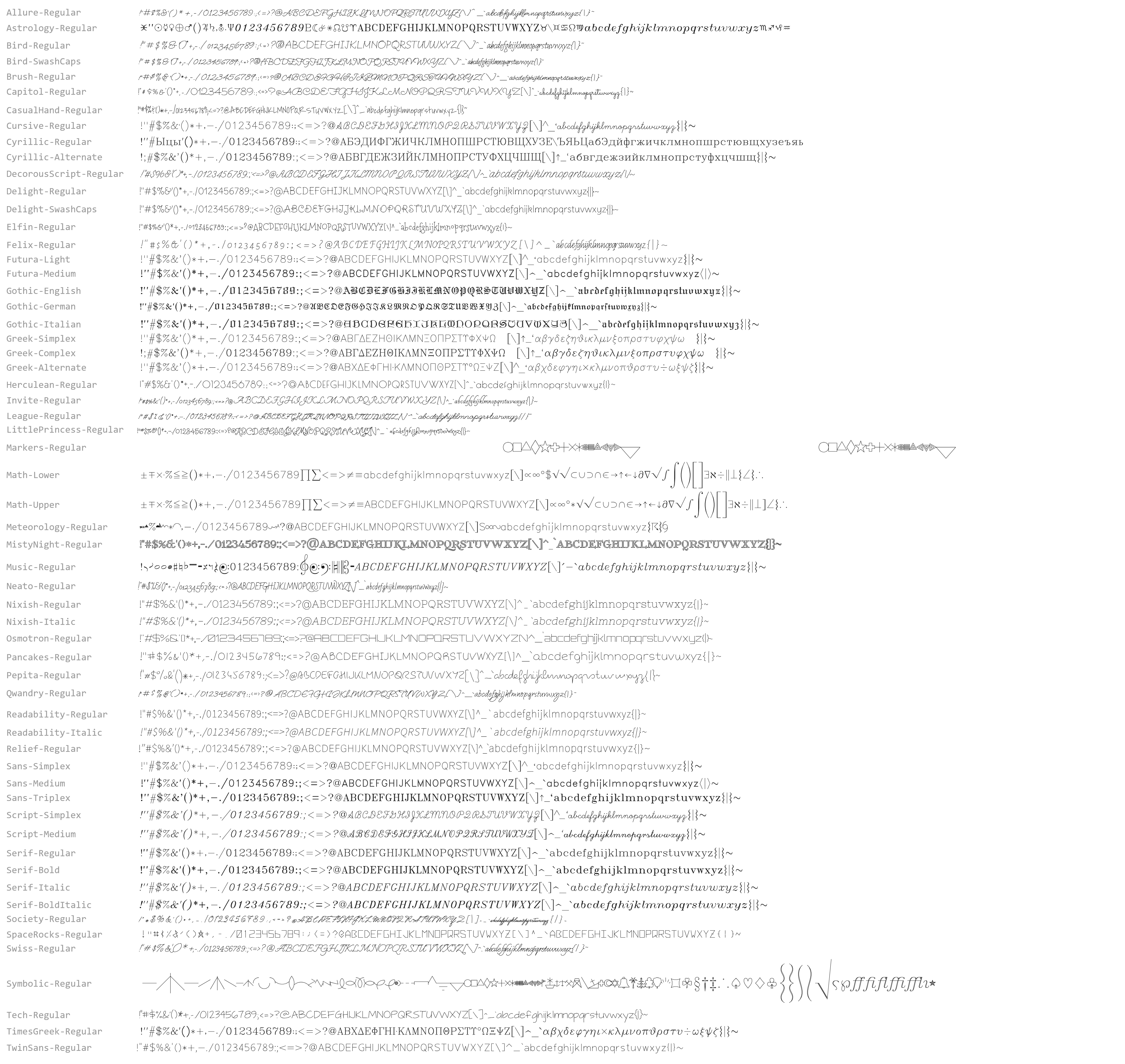

    This feature just got a full rewrite, sparked by the new FeatureScript MCP. The original decoded 31 Hershey fonts from a CSV. The new version carries 59 fonts across 42 families, adding the EMS and Relief single line SVG fonts. 41 of them now take accented and extended characters, and the SVG faces bring real curves instead of straight segments only.
    There is also a new font picker you can drop straight into your own feature's precondition: a family dropdown, plus a style dropdown for families with more than one. The function is renamed skSingleLineText() and still works as a drop in replacement for skText(), same inputs plus the optional lineSpacing.
    If you built on the old version, the rename is the one breaking change.
    The document publishes an All Fonts image showing every font's ASCII range, plus per font credits and licences. 30 of the fonts are SIL Open Font License and the rest are Hershey derived, and neither restricts what you model with them.
