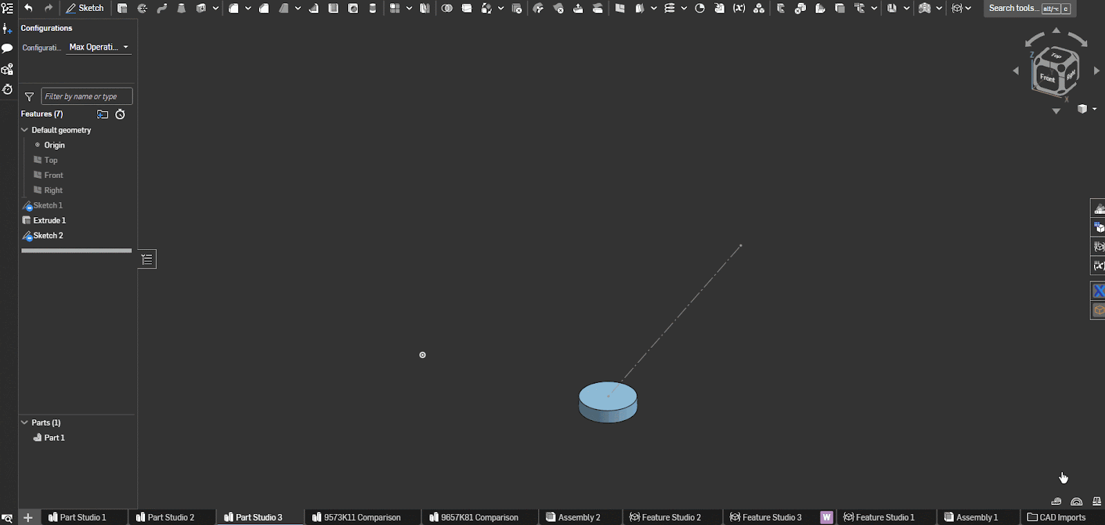

To make a spring you have two initial inputs, a Point or Circular Edge:
There are many options in the Spring Definition section including cylindrical vs conical springs, 4 different cross sections, different spring size definitions, number of coils, and adding mate connectors:
Next, you can change the end type and end style of the spring:
The length of the spring is always maintained no matter the end style so there is no need to compensate for them.
Also because this script is parameterized you can create multiple configurations of the same spring to define each position of its motion:
The main goal of this FeatureScript is to remove the need to download and import parts from manufacturers. Here’s an example of how the tool can recreate a real spring (specifically spring 9573K11 from McMaster-Carr) :
