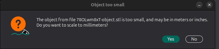

I'm getting an error when opening the stl exported file in Orca Slicer it's not in millimeters.
