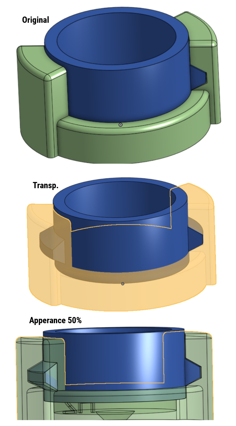

    I want to make the inner structures of a part visible.
    • Transparency makes the outer surfaces of the part transparent, so that parts behind it become visible.
    • Apearance makes the part so transparent that the inner edges are visible. In addition, this function is permanently assigned to the part until it is changed to 100% again.

    Sorry, but that is not correct.
    In translucent mode the inner edges are not visible.See the picture.
  • eric_pesty
    Yes they are in translucent mode:
    S1mon Member Posts: 4,636 PRO
    Maybe "translucent" wasn't well translated to German?
