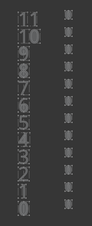

Hi, I tried adding your custom features but couldn't figure out what to put in the text field to include the variable. Can you help with this?
Does anyone know why this text is iterating correctly on the left, but not on the right?
Edit: Sketch 2 (the one that works is the original sketch from an older model that I found here) and Sketch 3 is a sketch that I newly created.

FTR, I found a workaround for getting text expressions re-evaluated in feature-patterns that doesn't require featurescript by instantiating derived instances of the sketch. See here;
