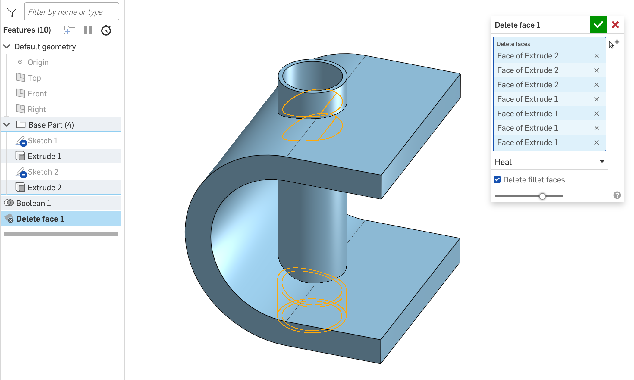

Thanks @NeilCooke and @Caden_Armstrong for explaining this to me and helping me out, you guys are incredible. Both of you somewhat suggested that I might be trying to do too much in one feature. Maybe I'm approaching this problem incorrectly so let me show the geometry I am working on, it's a model of a cylinder head that I am currently modelling (picture is cross section):
https://cad.onshape.com/documents/8930d09cea18509102a58ef9/w/0ed16bdc697984b61145d25b/e/866fdd7f806925a5f00cc85e
I modeled this in a number of part that I will join and trim at the end to form a singular part. I've been trying to simplify the topology on this thread, but I don't think I've captured the intent well. I think below is what I am actually trying to do and failing to find a simple workflow for:
Part (https://cad.onshape.com/documents/7a62577ef577a4bcf3e68e5e/w/68c67706492eeb1a60892313/e/4ba455e5696116441568d056):
Goal :
The fastest way I can do this operation is with 5 features! (4 booleans + 1 delete part) I'm new to onshape so maybe I'm approaching this wrong, but this seems excessive to do what I think is a relatively simple operation that other CAD programs can do in 1 feature. Is there a better way to do this? I do think 5 features is somewhat of an inconvenience even if it's possible.
Here is what I did: https://cad.onshape.com/documents/7a62577ef577a4bcf3e68e5e/w/68c67706492eeb1a60892313/e/179967c3e4c4642d89aeb349
There are many ways that this particular problem could be solved in fewer features. I would most likely go back and redo the way that the initial extrudes for part 2 were done, but assuming that the parts just exist (either imported, or derived or just too much history to muck about with) there's a pretty simple solution with boolean union and delete face/heal.
https://cad.onshape.com/documents/8a730fc58dd5a8de84d58ddc/w/d4c15f1553eecf0a4d24418a/e/5df83b664fae7b6b37565cf0

Hi @S1mon ,
Yeah, I think for most use cases delete face works, but it's an inherently destructive workflow and won't work for a slightly altered geometry. This is the case that I covered at the start of this forum post. If you have features that are "absorbed" by the first Boolean feature, delete face can't ever get them back, even if it's a simple feature. I think my 5 step boolean workflow is the only thing that I can think of to achieve it.
Link to new base part: Union Trim workaround | Absorbed Part
Link to my 5 step boolean still working: Union Trim workaround | Absorbed Workflow
