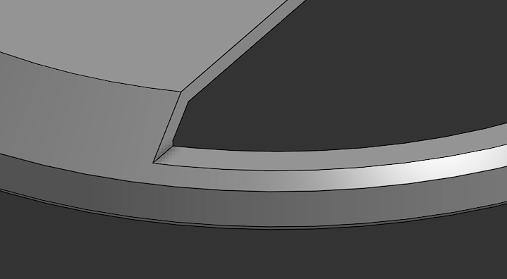

do you mean like this:
I don't think so but its hard to tell, that looks like the regular fillet tool which creates a curve along the entire radial face.
I'm looking to keep the selected face flat
Depends on what exactly you're asking of this fillet. Easiest solution is to take the fillet exactly to the bottom of the lid, thusly: https://cad.onshape.com/documents/f62756ba36438dddd7c73f9a/w/b120076dd65dbe57887c613e/e/3f0049b6328a3395f8c24dd9
Using width fillet is another option: https://cad.onshape.com/documents/f62756ba36438dddd7c73f9a/w/b120076dd65dbe57887c613e/e/fdf38b0bf83b33c2353886d8
Like this?
I would probably use a couple of bridging curves and a boundary surface. Then you could make a small chamfer or fillet, and replace that face.
throwing my hat in the ring. This solution is very flexible.https://cad.onshape.com/documents/9a6ca0c6773ba398f1268908/w/c8c32e3b908a8b65897c32dd/e/87810b113552842643c13476
variable fillet is probably what your looking for.
ooh clever use of that!
