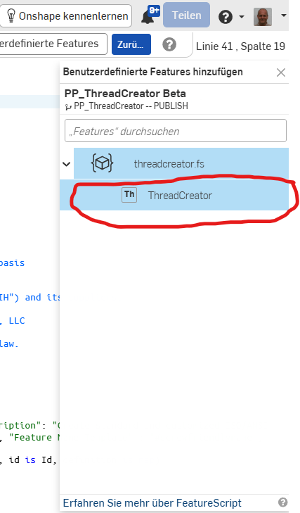

Hello! I just got into the amazing world of onshape a couple days ago. I am trying to make a holder for a usb microscope. I was hoping to screw the holder into a base. That way, I can use the base for other "holders" in the future. It seems the base part exports with internal threads from onshape to stl. However, I am having trouble exporting the holder which has external threads. When I export the holder in either stl or 3mf format the threads are not visible in the slicer. I am using bambustudios for printing. Ill add the onshape screenshot showing (in green) where the threads are and the bambulabs screenshot, showing now threads.

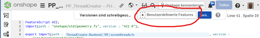

  • klaus_krämerklaus_krämer Member Posts: 65 ✭✭✭
    I'd recommend the ThreadCreator Tool. It works quite well, even if it adds threads to inner zylinders instead of carving them out.
    When I use it in sizes from M5 to M8, I use a cylinder diameter of x mm for Mx screws and a diameter of x+0,4mm for threaded holes (inner cylinder). With these I can use either printed screws/nuts or normal industrial screws/nuts in any combination.
    Simply try it out printing them and test with their metal counterparts to find your preferences.
