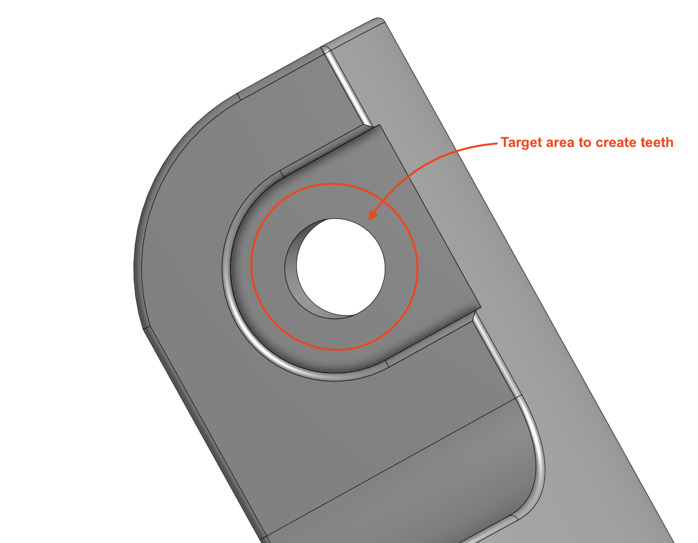

I'm battling to find anything helpful on the problem I'm trying to solve.
I want to creat teeth/grooves around a hole to lock a swivel bracket into place when it's fixing nut is tighthened. Best to describe is by an example photo of a part that I'm trying to customized.
There are 18 teeth in total (20° angle between teeth) and the depth is 0.8 mm.
This is the part where I want to add the teeth:
Any help/comments welcome.
  • Matt_ShieldsMatt_Shields Member, Onshape Employees Posts: 865 PRO
    You could create two 20° wedges and loft between them.
  • joos_louwjoos_louw Member Posts: 4
    Thanks Matt, I just couldn't warp my head around this problem. Sorted!
