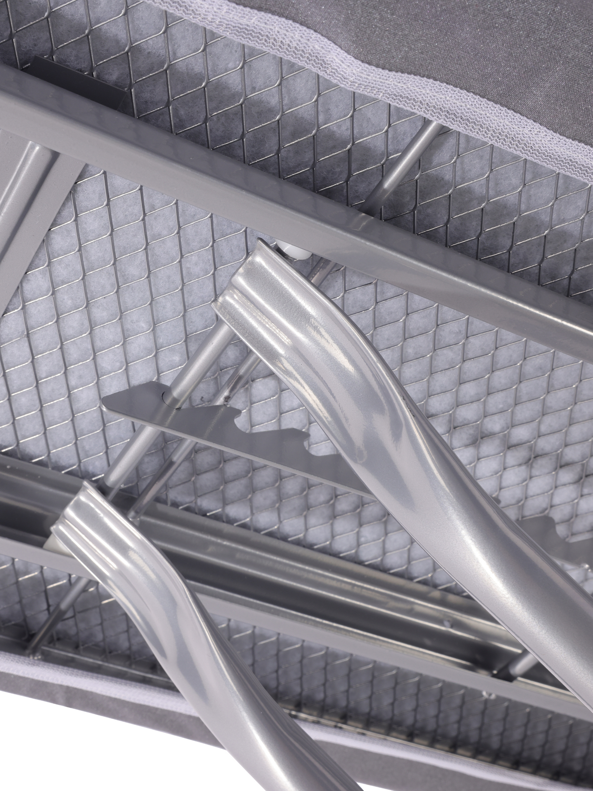

    This is an interesting modeling problem, but I would ask why make things so complicated? Ironing boards solve this by having a rod or pins which hook into a series of identical slots.
    Ironing board with steam unit holder - Light Grey — Buxibo – BUXIBO

    S1mon Member Posts: 4,456 PRO

    Thank yall very much for the tipps and tricks to solve this problem. I solved it in another way: copying two lines representing the two legs a bunch of times and offsetting every line a bit more and then take transform pattern to transform the tooth to every position. That worked for me but this onshape tricks are really great. Also the idea with the ironing table is really great thanks for that!
