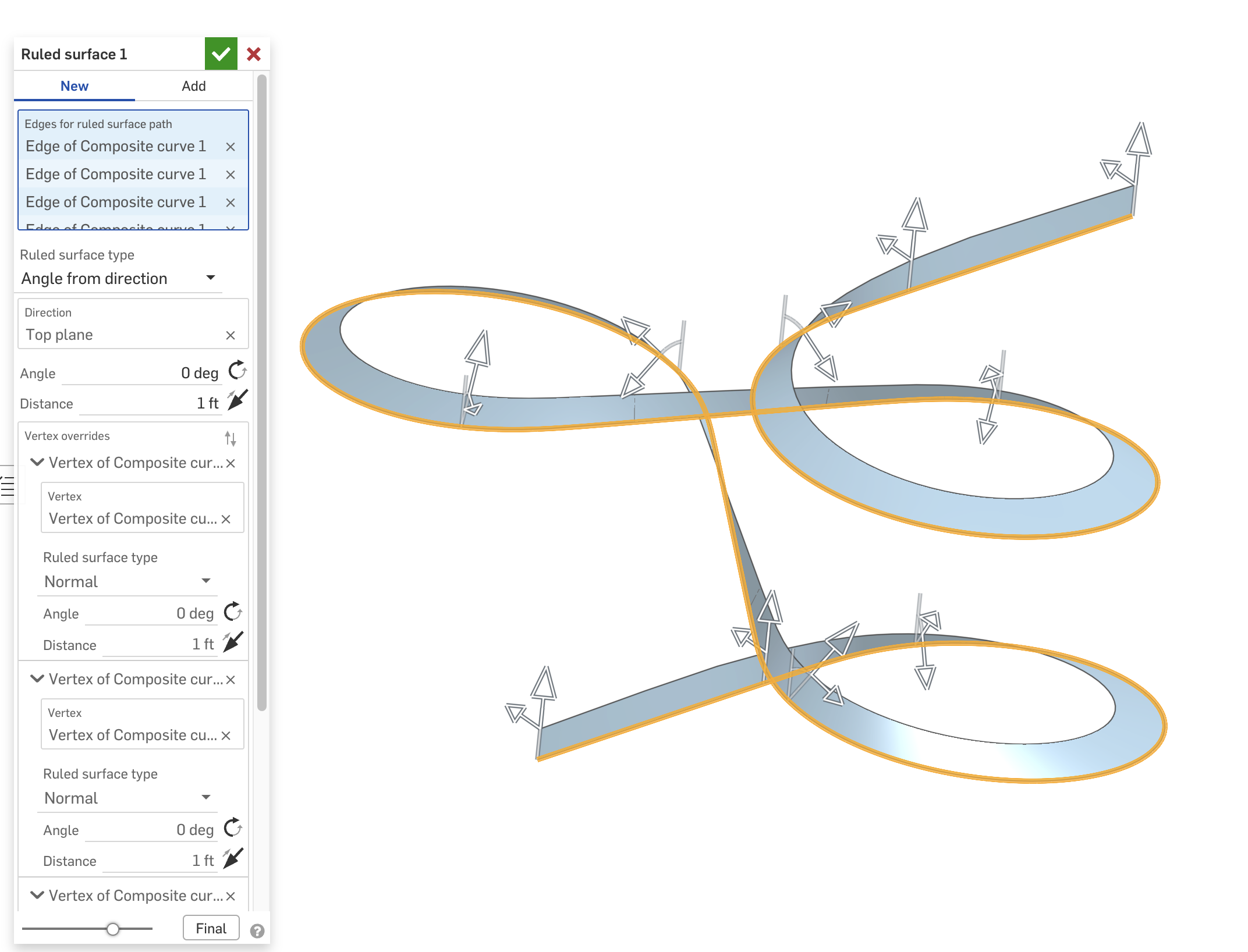

You can also turn one derived sketch into a surface and then transform/copy that body to the other locations. Flat surfaces or closed sketches both operate pretty much the same for lofting, etc.
@eric_rollins Use a ruled surface to make a reference for the sweep feature to use as a "face to lock".
In the Ruled Surface
In the Sweep
Here's an example I did recently of this.
@EvanReese thinking real hard about how I could simulate theoretical G force vectors on a curve to make an auto roller coaster script with this ruled surface approach as the basis. We've got some twisty ball track that's always been a bit of guesswork at figuring out the bank angles but it doesn't need to be.
