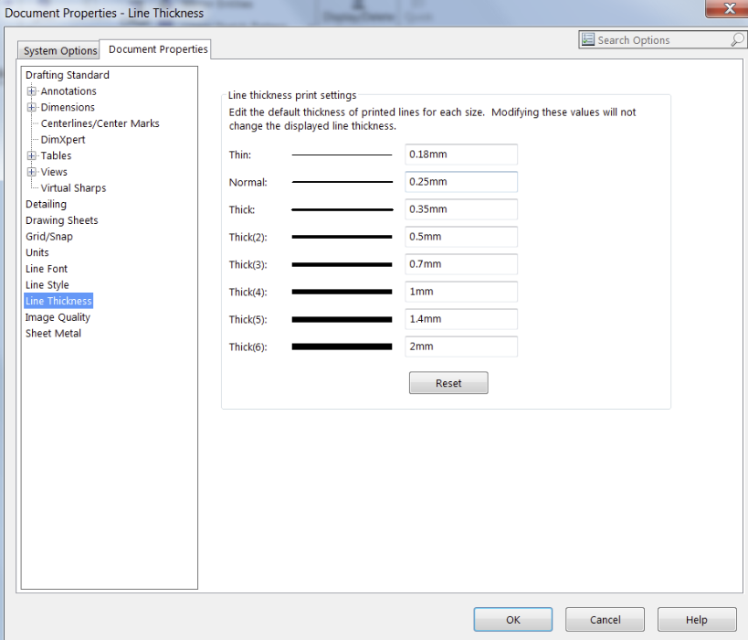

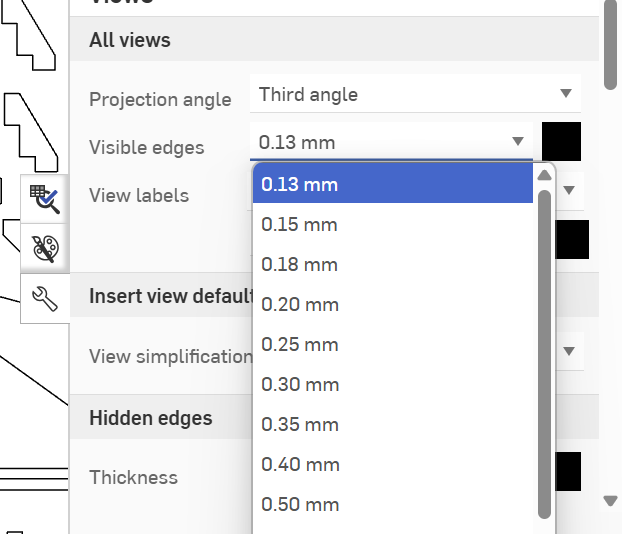

In Solidworks I am able to chose any line thickness I want my drawing to print to a pdf while in Onshape you have to select a pre set value. My main problem with this is that my laser Cutter will only do a vector cut if the line is .002in and raster(engrave) if it is any larger. This leaves me unable to use Onshape with my laser. I had to export it as a dxf file then import that into Solidwork to make a pdf that works with my laser. This is a feature that Onshape really needs to implement.
