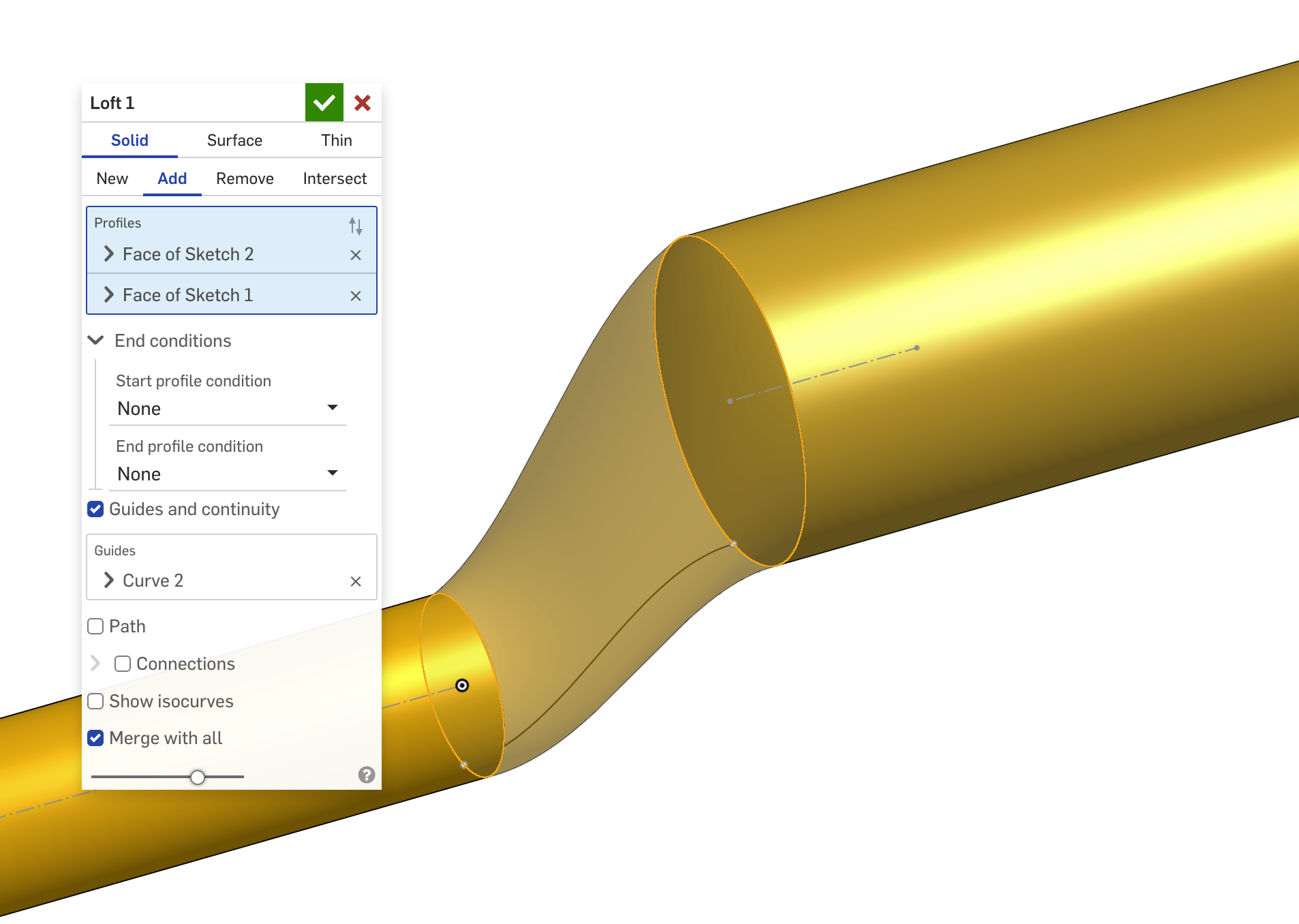

Hello,
I saw some posts on this forum about it but none helped me.
It surprising me because I don't think my issue is really specific so I think I am doing something wrong.
As you can see in my document, I want to design the profile of a tube.
However, when I want to connect the different parts together, I have an "self-intersecting body" error.
I've tried to use the "curve / surface analysis" like I saw in another post without succes.
I saw some people recommend to change the radius of the tube or the offcet between them, but I don't want to.
Thank you in advance !
Here the document with the issue :
https://cad.onshape.com/documents/f0d7c435d9b0c7b954389383

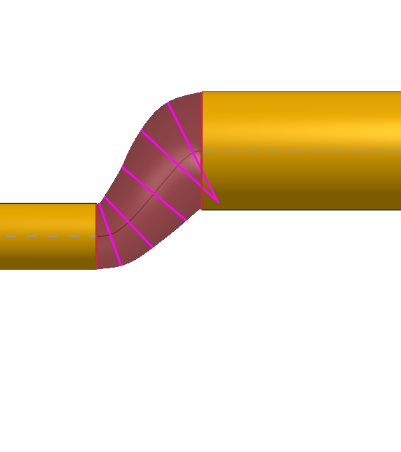

  • michael_stalls
    michael_stalls Member Posts: 74 PRO
    the iso lines folding back into the tube indicate the issue…make the part "new" and you might have to add some guide lines on the top and bottom of the tube and on each side if you want to keep the profile circular.

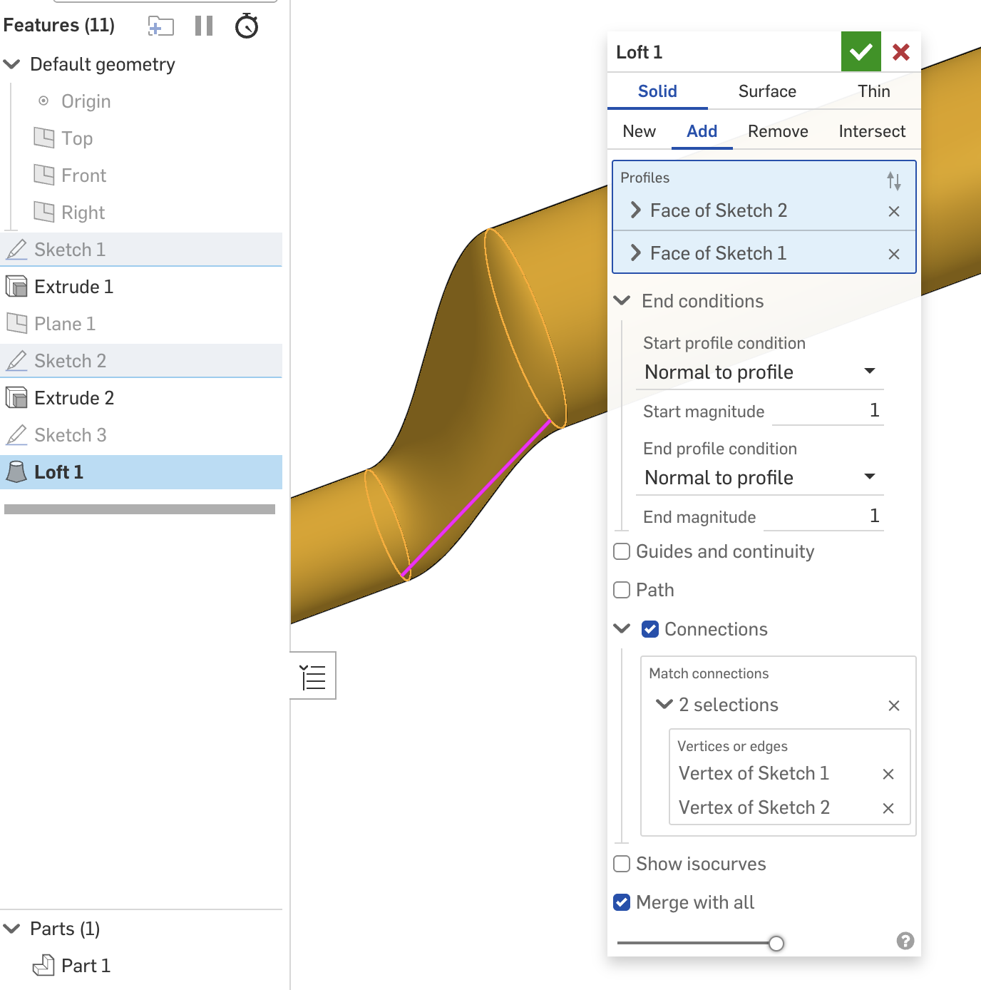

    Okay, thanks to you I could do it, you can find what I've done here :
    https://cad.onshape.com/documents/b46b793b44b678511fee89fa/
    It's not yet really natural but I will try to play with the magnitude of the 3D Fit Spline.
    However, I have a lot of curves and sketches.
    For 10 links, I need 20 sketches and 40 curves.
    Is there no other way ? Are we touching a limit of OnShape ?
    For the maintenance that's not really nice :/
  • Matt_Shields
    Given the complexity of other Onshape models I've seen, I can assure you that we are nowhere near the limit of Onshape. That said, I do think you could streamline your workflow a bit. For constant diameter sections, I think you could use a sweep, rather than a loft with guides. And for a lot of the other lofts, unless the required profiles are very specific, you could scrap the guides for start/end profile conditions.
  • benoit_maurel
    benoit_maurel Member Posts: 18 ✭
    Thank you for your answer.
    I understood why it didn't work when I tried this.
    I had selected "match curvature at strat/end" and that was the issue.
