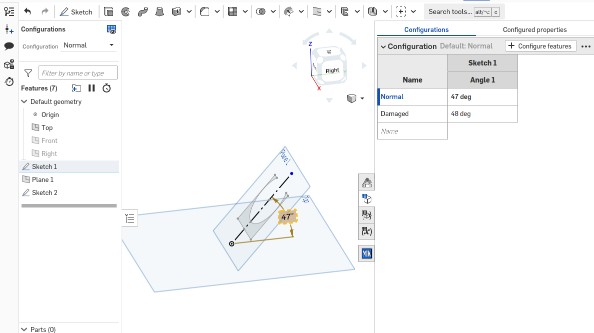

Several times I have encountered a situation when when changing the angle of inclination of the plane, the snapping of elements in the sketch also changes. It seems that the coordinate system is changing. Made a test drawing : https://cad.onshape.com/documents/c26191c81cd466de29cce6c8/w/cdce6d872533fd8340e131ee/e/934c6004ff8915dd87dc10e3
A normal sketch at an inclination of 47 degrees :

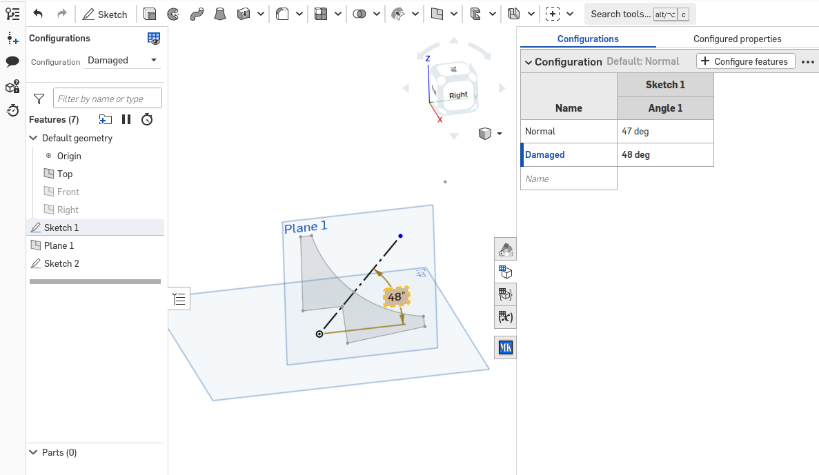

But at an inclination of 48 degrees, the plane rotates 90 degrees relative to the axis and the sketch elements are displaced. At the same time, the variable angle of inclination should not affect the rotation of the plane around the axis in any way.
There were cases where the plane remained in the correct position, but the sketch changed orientation by 180 degrees, destroying the integrity of the depicted structure.
I do not understand such behavior, especially with such banal angles as 47-48 degrees (this is not 90 or 180). At the same time, in my model I cannot avoid them. Please explain what is happening and how to get out of such a situation.

    In the Plane 1 feature you should add the Top plane as an additional reference to disambiguate the normal direction of the plane you are creating.
  • sergei_nesterovsergei_nesterov Member Posts: 45 ✭✭
    edited August 2025
    Thanks for answer! It works. But I don`t understand why. The Plane definition requires only a Line and the Angle. In addition, the link of the Plane 1 to the Plane Top occurs through the Sketch 1. In this sketch, the angular size connects the line and the Plane Top. Nowhere to indicate the presence of ambiguity. I did what the interface asked, selected a Line and the Angle. Does this situation described in the Learning Center ?
  • eric_pestyeric_pesty Member, pcbaevp Posts: 2,509 PRO
    A really good way to deal with this is to use a mate connector instead of a plane. That way you have full control over the sketch axes
