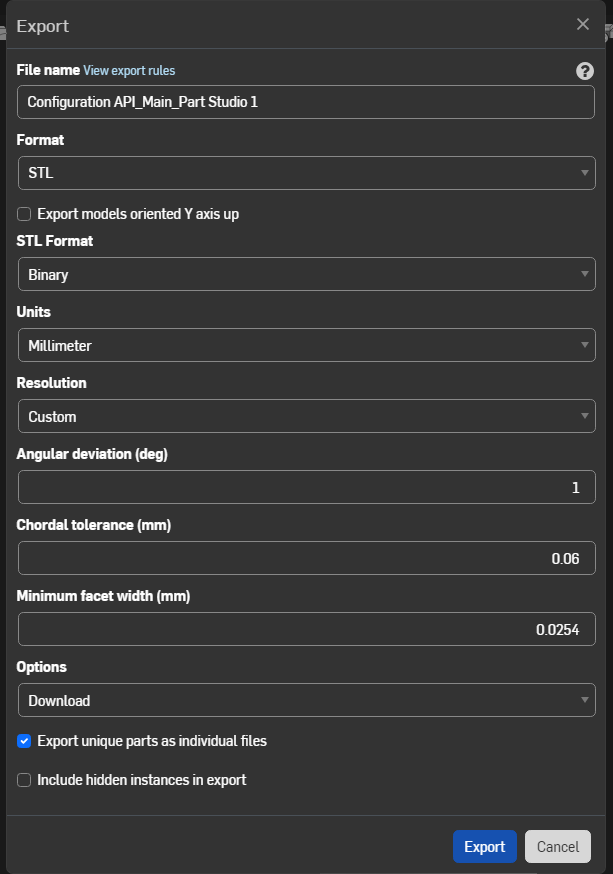

I'm trying to create a one-click export current state of a part studio using API and extract downloaded file.
So far it kind of works: it downloads zip file and extracts it, however the downloaded model is not the same as in part studio, because of the configuration (I'm using this document for my tests):
  1. how do I get current configuration? When using https://cad.onshape.com/glassworks/explorer/#/Element/getConfiguration
     it pulls only the "default" values, not what currently is set in the part studio
  2. using https://cad.onshape.com/glassworks/explorer/#/PartStudio/createPartStudioTranslation
     with these parameters:
    {"formatName": "STL",  "stlMode": "BINARY",
      "grouping": false,  "storeInDocument": false,  "unit": "MILLIMETER",  "resolution": "FINE",  "configuration": "List_ZtPTSWsj4qojhC=_2;top=10mm;bottom=20mm;linked=false"}
    seems to be ignoring unit and resolution parameters. The stl exported in meter, with very low resolution (definitely not FINE).
  3. Is there a way get settings from export dialog?
Or maybe there is already existing code for this?
Thank you.
