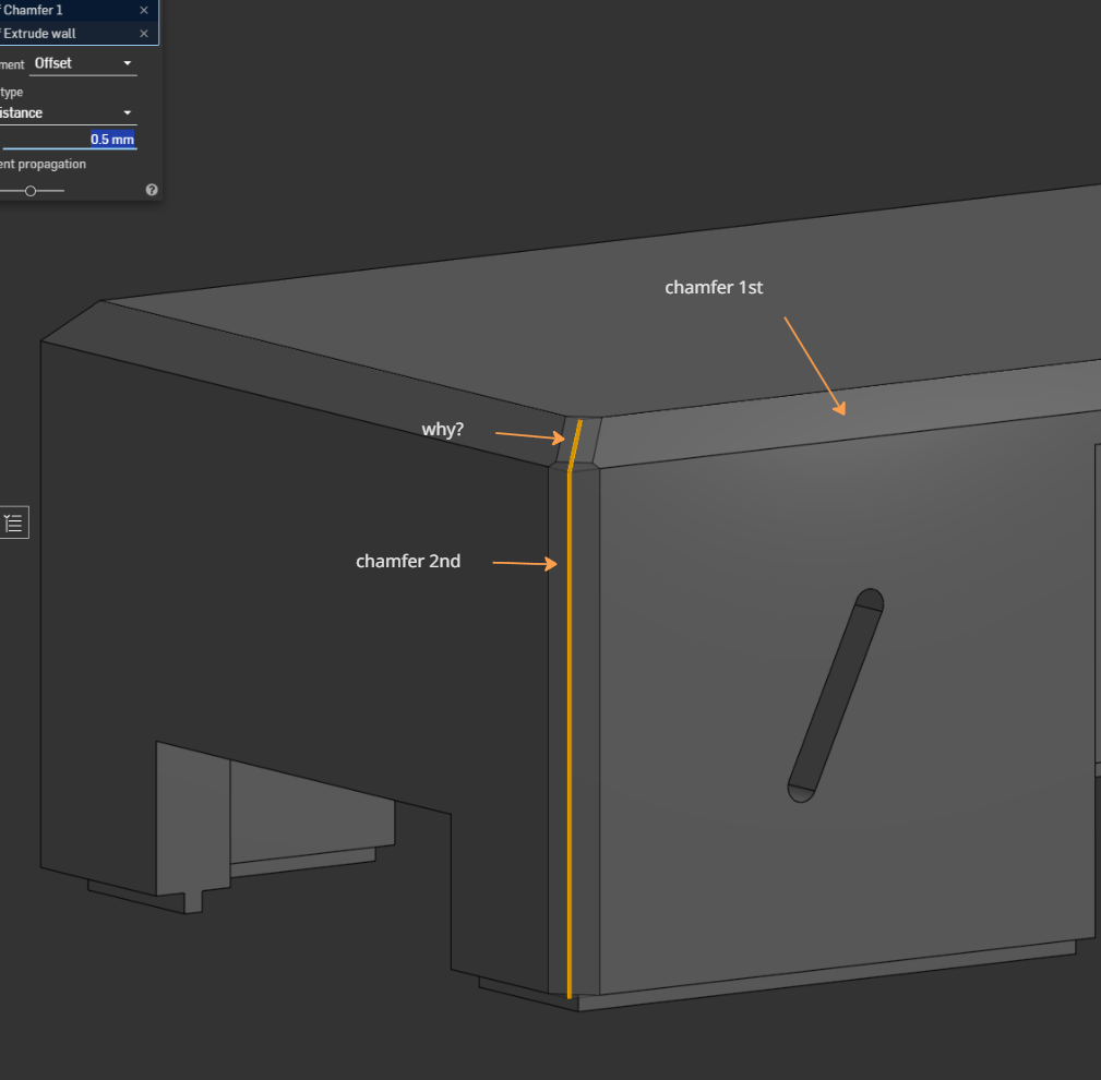

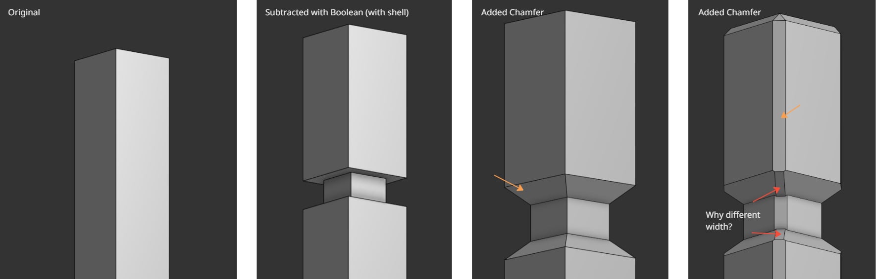

Hello! Have a problem with continues chamfer on the edges after Boolean operation. On the screen you can see the different width, can't solve it for days, the only way I found is to create first chamfer shape (3rd screen) with Loft and after vertical edges will Chamfer ok, but it is a very tedious way. I tried to connect vertices on 2nd screen with Bridge Curve, but Chamfer is not considering it either.
Thank you for any help!

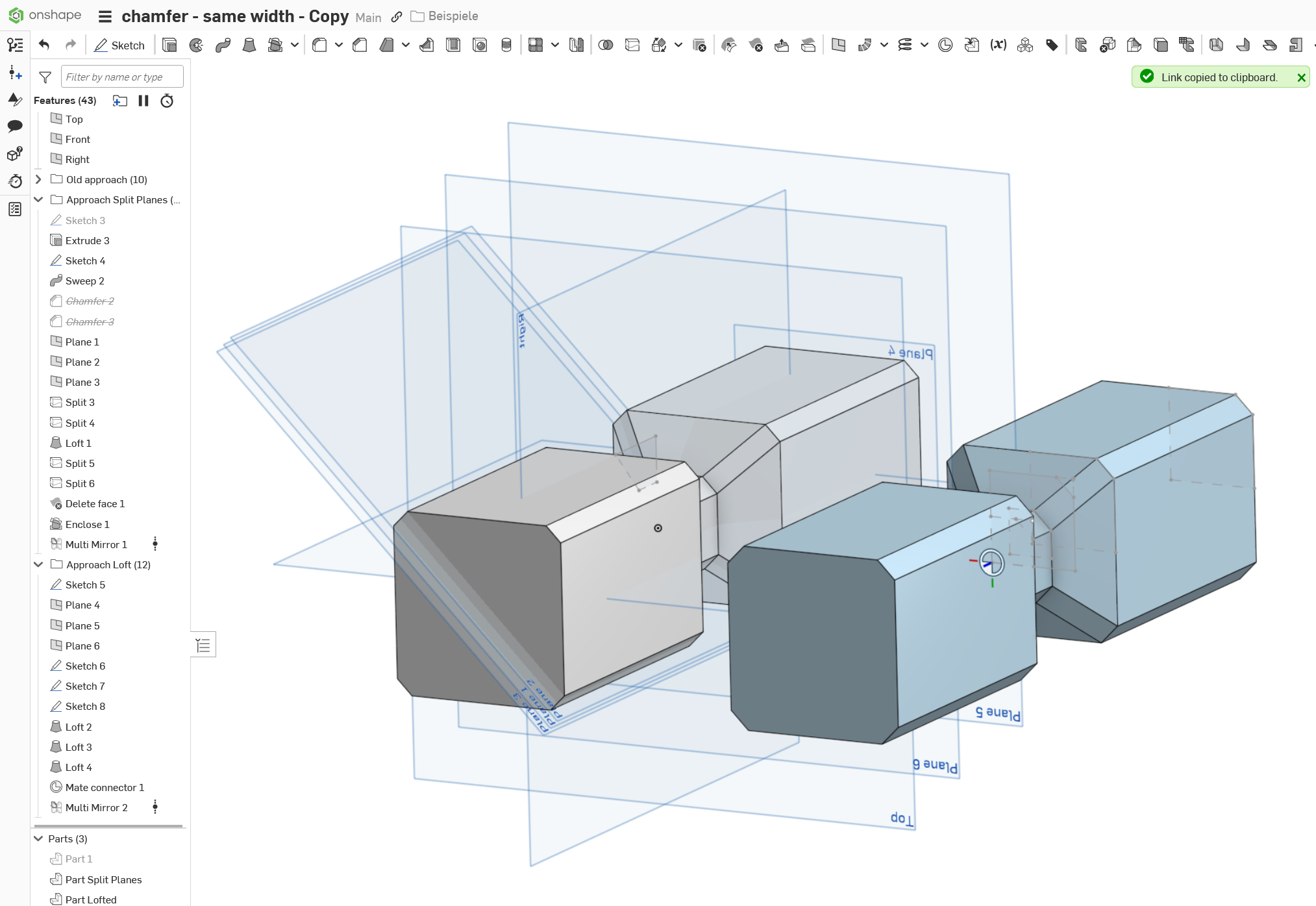

    Hey @alexander_novikov722,
    I can think of using a loft to do this: https://cad.onshape.com/documents/6602bfbd29c639087a03c5d2/w/4569d2862c0c11e3125f8d5d/e/c4a52348ffb88993febf35f6

    In my experience, it has never been a good idea to apply a chamfer which completely removes an adjacent face, like in this case. That only means asking for trouble downstream.
    Anyway, in this case, the chamfer only APPEARS to be a different width, while it is mathematically correct and the same width: The chamfer at the angled 'pyramid' part has the same distance to the original edge like the others. It is only not measured in any of the orthogonal directions, but perpendicularily to the reference edge, which is at an angle, in this case. To math the two visually , we'd need in fact different width chamfers!
    Since Onshape has no chamfer by width or chamfer up to boundary curve, we'll have to do this one manually.

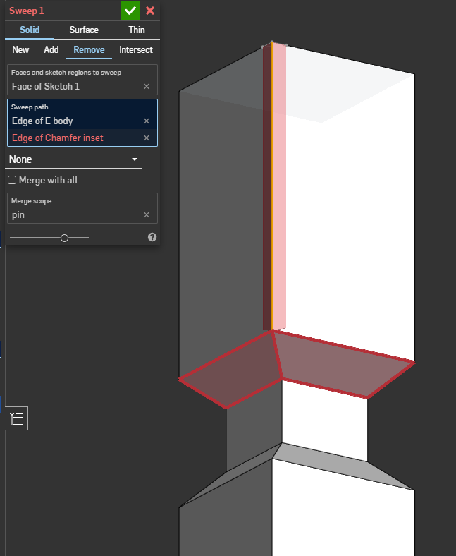

    Another option would be to sweep a cutting profile along the chain of edges.

    David_YL_Nguyen, thank you for the help, I'll try it today, saw on your model you used Sweep, I think it is what I need!

    David_YL_Nguyen, unfortunately on my model sweep is not picking the edge from the 1st chamfer. In your model you did inset in the sketch at the beginning, but I got that shape after boolean, so maybe because of that…
    UPDATE: nevermind I missed Keep Profile Orientation in Sweep settings. all works thanks!
