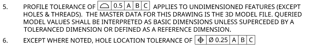

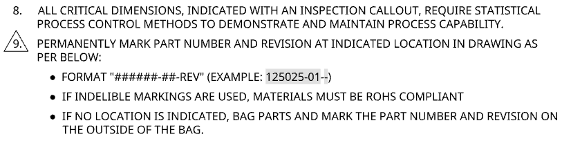

I have to say, putting in standard drawing notes that don't look terrible, is one of the hardest and least rewarding parts of Onshape. The formatting tools are slow, buggy and clearly only tested with limited scripted interactions. The preview (before you close editing) is completely different than the real note display. Flag notes completely blow up the line spacing, especially a default sized triangle note. And trying to manage bulleted lists under a numbered note is extremely twitchy.
We want this:
When we create a drawing template, we can carefully noodle around with the formatting tools and set the triangle flag to "tight" spacing to get this. When we export to a DWT, the triangle gets converted to lines which are pasted behind the text, so it's no longer parametric and linked. WTF!?!
If we're being more accurate, flag notes shouldn't have periods in them. Creo, Inventor, etc can do this. This isn't rocket science.

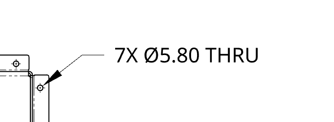

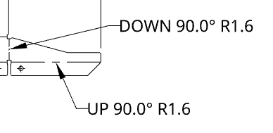

    While I'm ranting about drawings, why are leaders for dimensions formatted differently from bend notes? Why would anyone want the leader to touch the text for bend notes?
    edited August 2025
    I had to do this shit exactly a few months ago. It hurt my soul...

    Notes are so important for communicating manufacturing information, that making them super readable is critical. In addition to what's already been written here, the notes block can be tagged as an Inspection Item. but this is for the whole block. I often put a numbered list of manufacturing instructions of which, say, number 3 and 9, I want checking and recording. But I can't add more than one inspection item to a block of notes and the one I do add applies to everything in the note box. If I split the block in two, I then can't set the numbered list to carry on from the first block - so I have to number it manually with all the editorial risk that entails.
