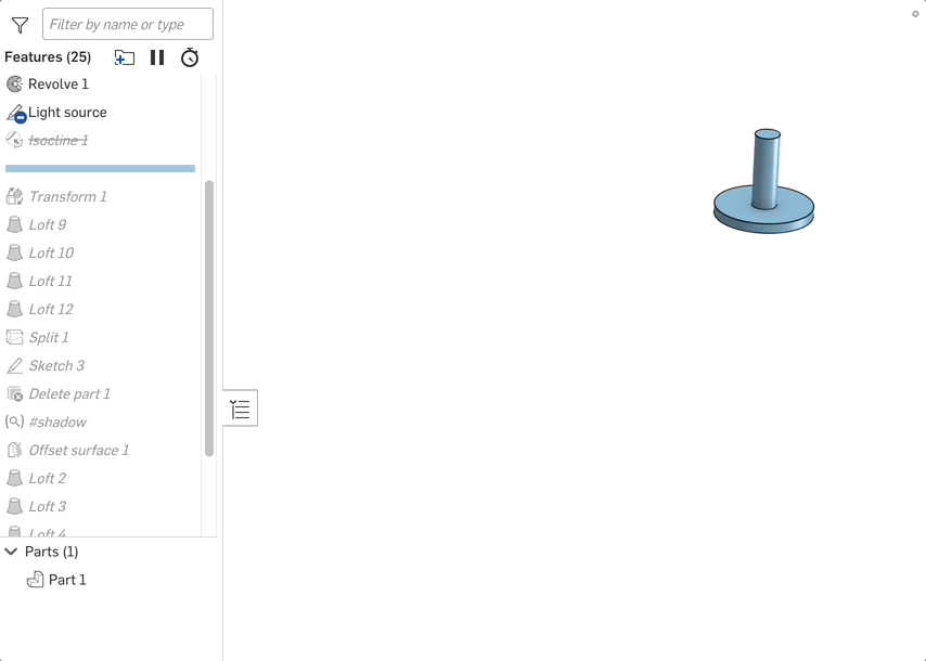

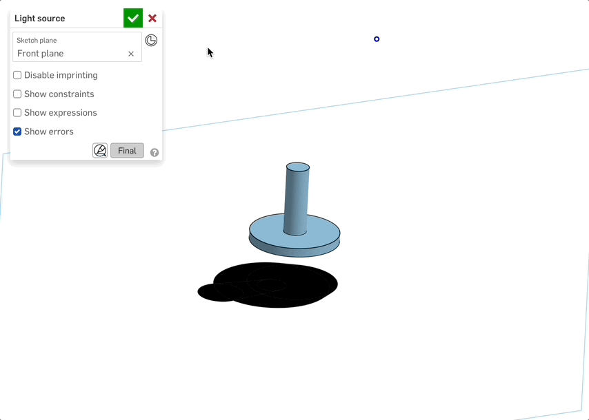

    Optics won't be much help in casting shadows from a point source and I'm not aware of a feature that will. This kind of problem seems related to isoclines, but not perfectly so. One idea to force FeatureScript to do something like projection from a point is to scale the input body from the point till it is fully through the plane you're casting onto, then lofting between them somehow (face-by-face, splitting as needed?), which means I agree with @Derek_Van_Allen_BD that it's kind of like a Body Loft operation. For simpler things like your example, you can do this manually the same way, like this. For curvy shapes, i'm not sure yet.
    https://cad.onshape.com/documents/3ca15967b4931ac0ef7acfe1/w/c5cf855c1a9eb71dbe13c59f/e/428f838a03d7331e574e518a
