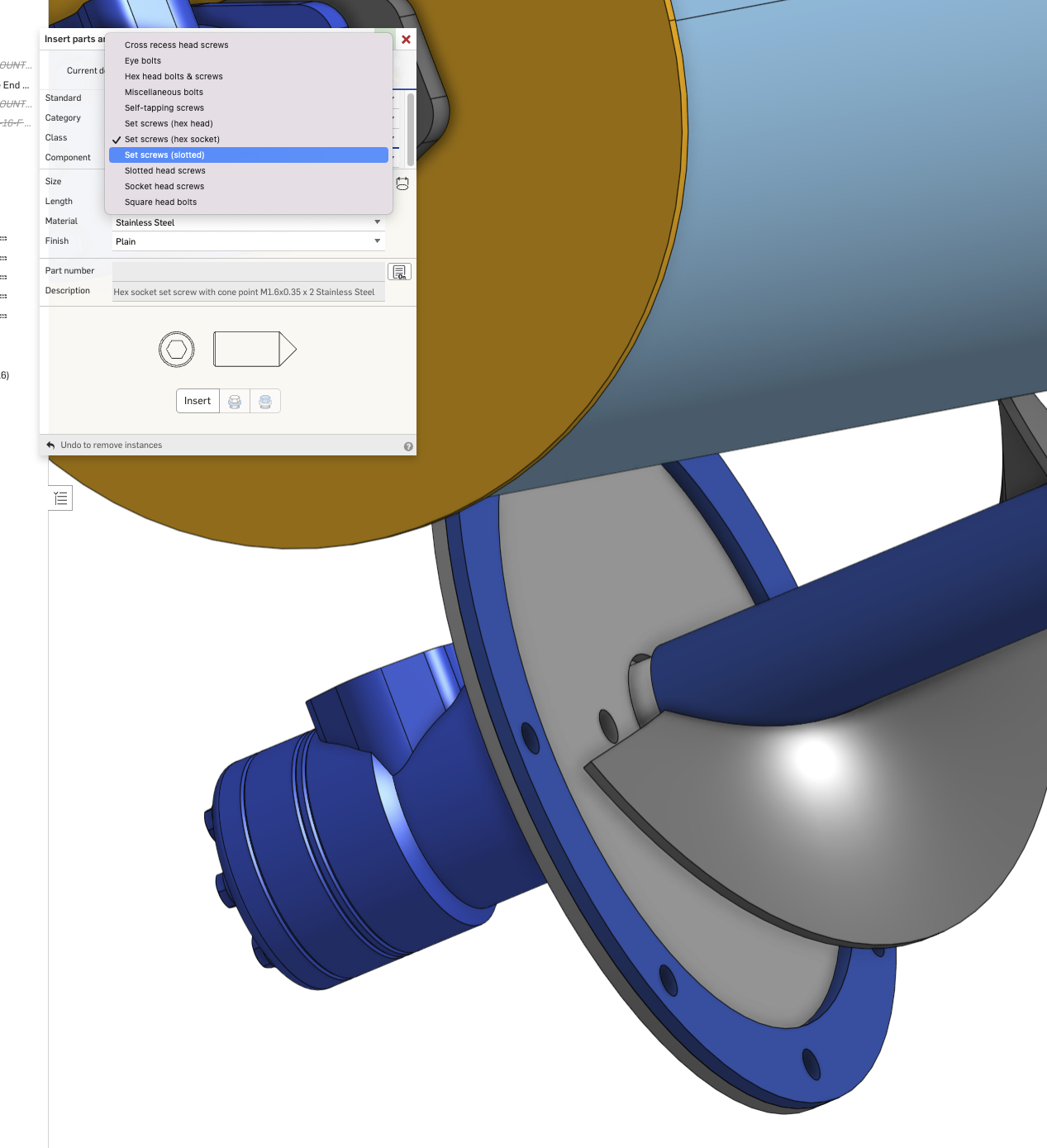

I find standard content extremely hard to use. I want something much more usable, more like a commercial catalogue. What are others using?

    My biggest pain points:
    1. A lot of relatively common things are missing.
    2. Sizes are missing.
    3. You can reconfigure to some degree, but you can't swap any screw type for any other screw type.
    4. You can't add "standard" OTS stuff that's missing that your company uses all the time.

    I use the standard content a lot, but I often have to work around the shortcomings.
    • If a standard (EN, ISO, …) is used, ALL sizes the standard allows should be available.
    • More types need to be included. MUCH more types.
    • The types should be organized better (Filter/Menues) and previewed accurately.
    • At some point in the design it might be necessary to swap one head type for the other, which is not possible.
    … and countersunk screws never ever appear to insert into the correct position.

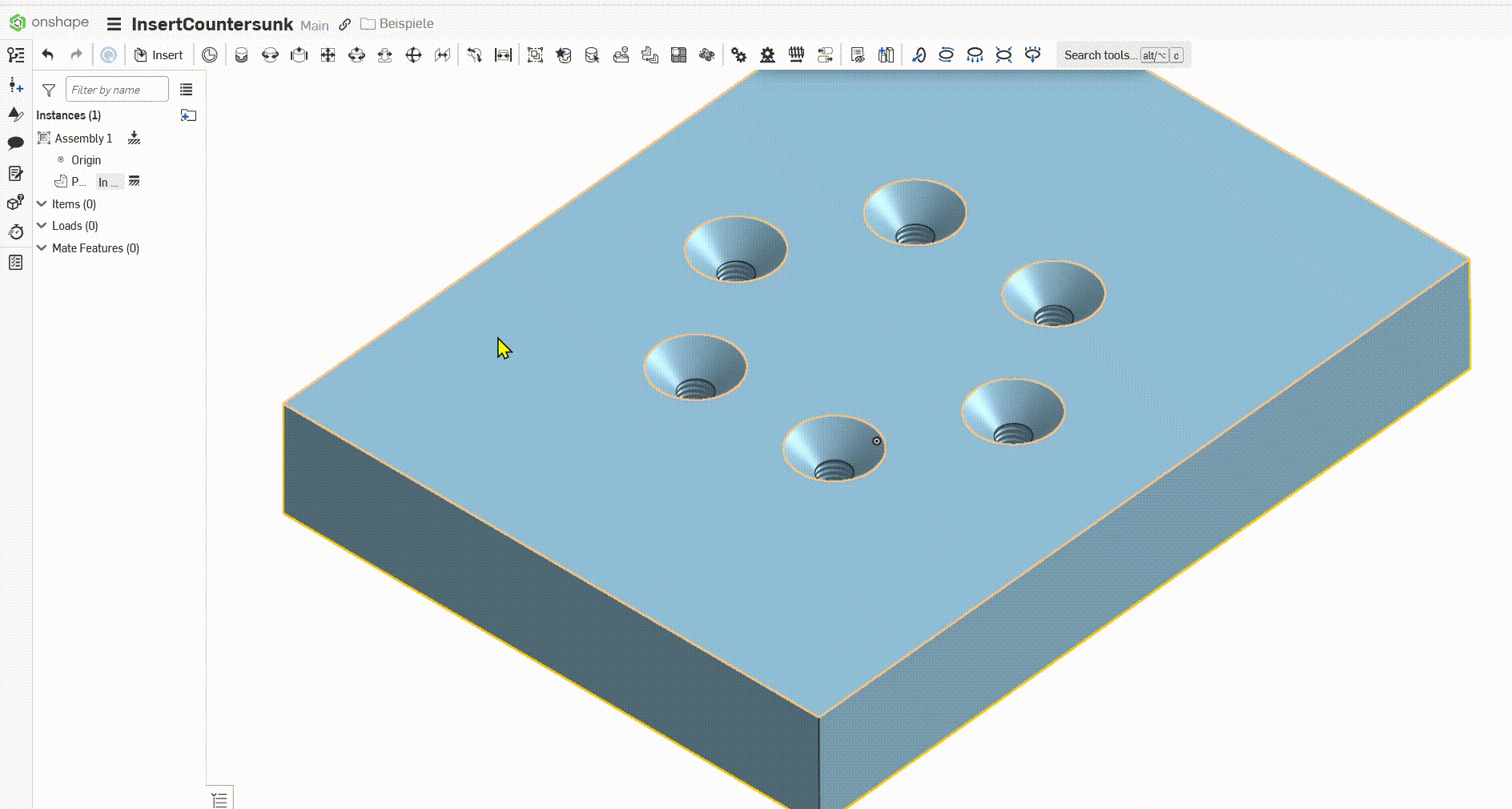

    I assume by "countersunk screws never ever appear to insert into the correct position", you mean that the snap mode isn't doing the right thing? That's annoying.
    I was surprised to learn some tricks in this video:
  • martin_kopplowmartin_kopplow Member Posts: 1,091 PRO
    edited September 7
    Yes, but it does not create a parametic connection and frequently fails, especially with length (and countersunk screws). So if we change the hole, the old bolt stays in and no error flagged.
    Yes, but I did not mean the manual snap mode doesn't do the right thing. I mean the insert standard content tool itself: In OS, countersunk screws are meant to be referenced by the point of the countersink/head cone. When inserting into preselected holes, this does never ever work, though. The autosize returns an error and when the correct fastener size is set manually they end up being inserted too high or too low or even upside down. Also the insertion of multiple bolts in a preselected face doesn't work with countersunk (only in rare cases). I usually have to insert them one by one.
    Possibly, the tool expects a face and a cylinder to work, not a cone.
    In theory, it should put fasteners into all hole in this face. It doesn't, only places one at a time. I already tried other 'non.documented' selections that could make sense, but they just do 'non documented' things then ;0)

    Basically only three bugs:
    • The multiple holes in the preselected face don't get recognized.
    • The insertion point doesn't get recognized.
    • The multi-insert doesn't work.
    The rest is just playing around to show what might be a meaningful approach and that the results are inconsistent. Anyway, far from satisfying.
