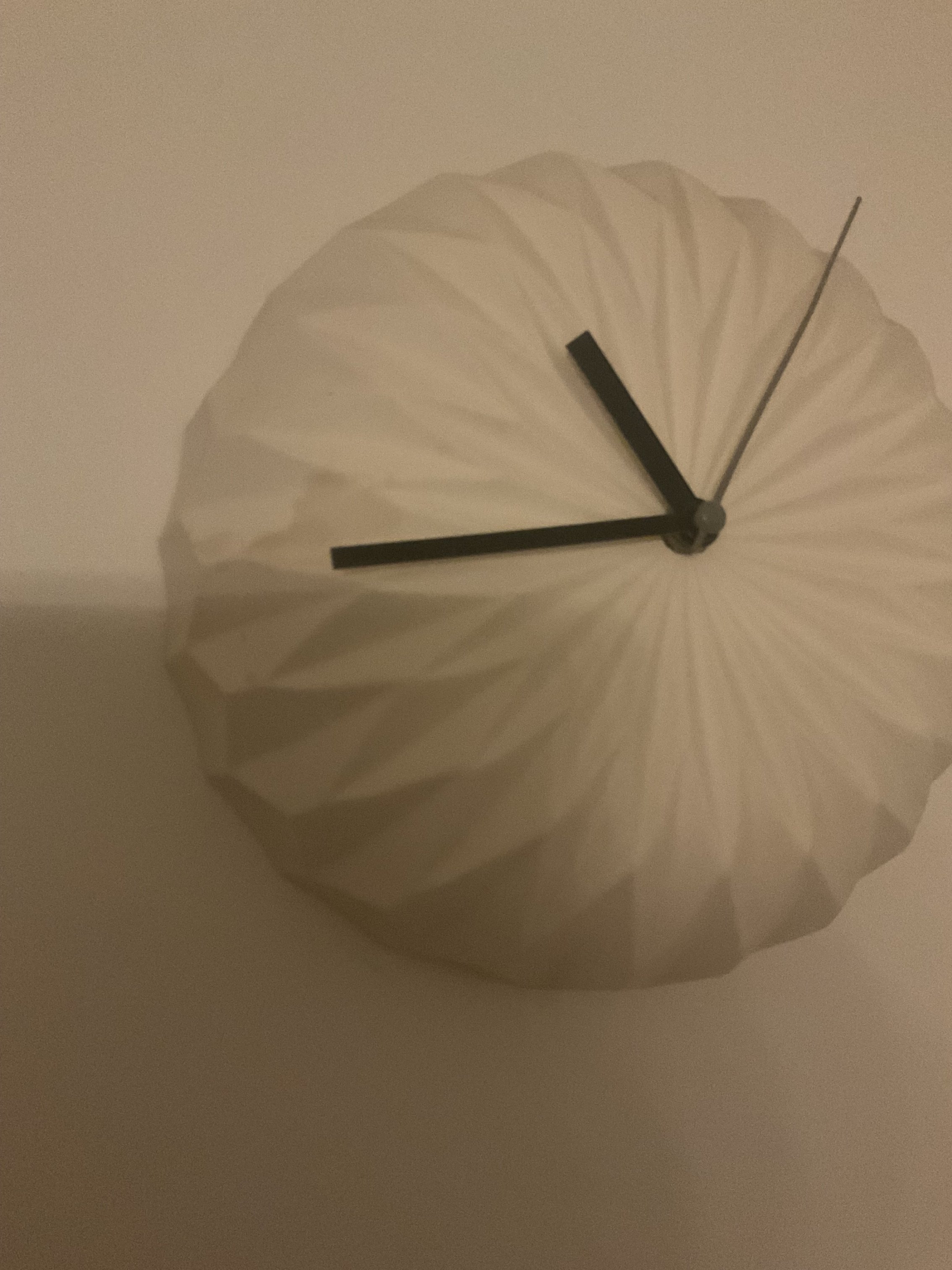

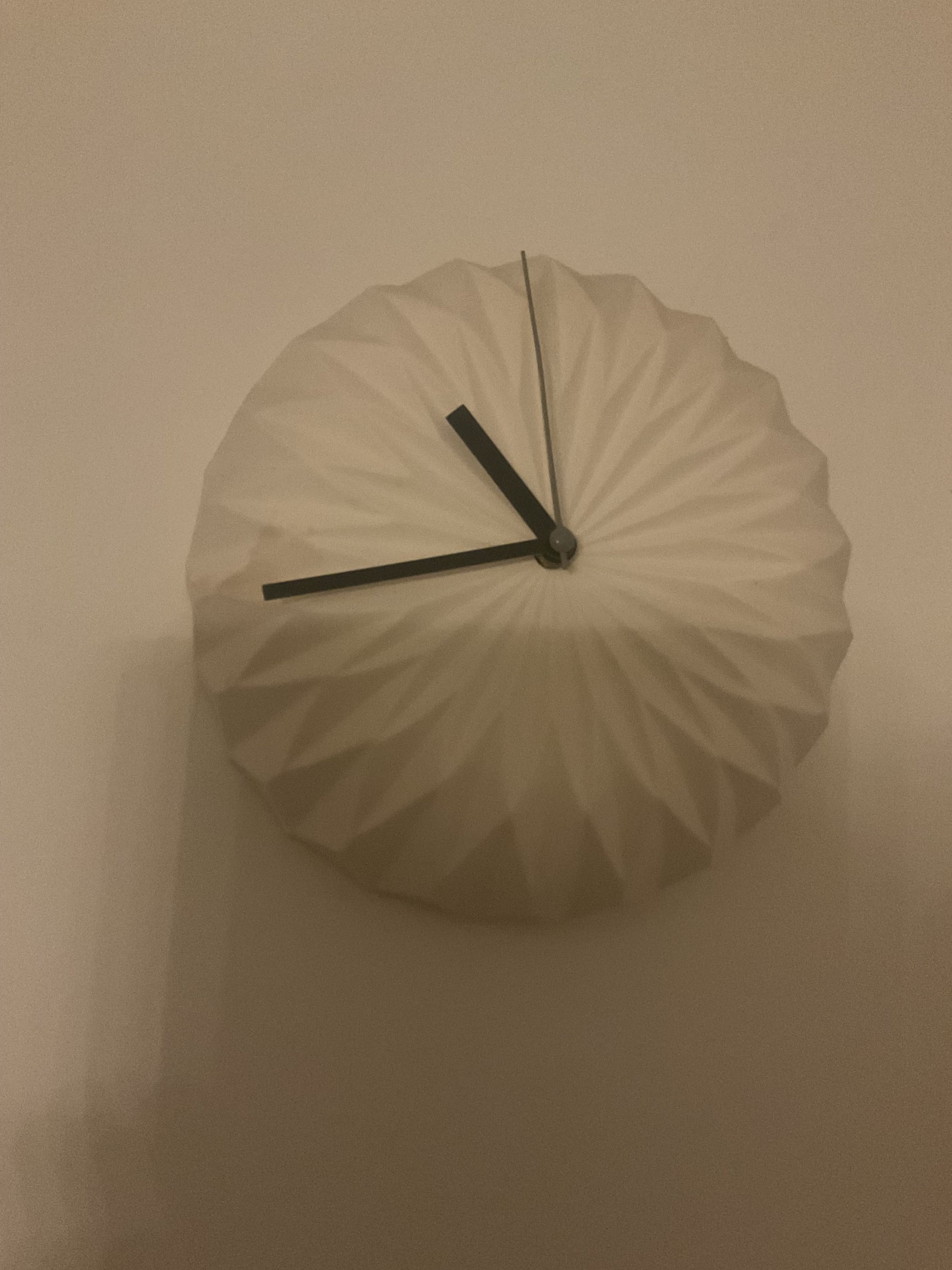

my wife has this clock witb a nice pattern and really want a patten like that on a sphere also and maybe other things
But sad to say after a few (lot) tryes its more than I Can at the moment π Can anyone lead me the right to understand how to do it.
i add pictures of the clock so the pattern Can be seen.

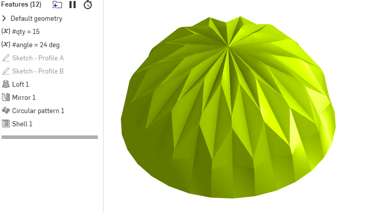

Hey @steen_pedersen968, there are several ways to get shapes similar to this.
Here is one way to do it by sketching the profiles then lofting them together and creating a circular pattern:

Here, I simplified the steps a bit. There were a few redundant things.
Note that Sketch - Profile B, uses an implicit mate connector to control the angle of the sketch plane.https://cad.onshape.com/documents/70301bdee67da94c01f314aa/w/faadf4a93585be3342174450/e/525c24cβ¦

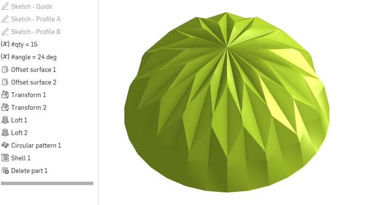

@MichaelPascoe thx have work something with a sphere design but just need to figure out the middel part on looks weird :)
just have to figure the big part in top out so that can be in the middle aswell :)
The point with this kind of shapes is to get the brain to accept that they aren't what they look like at first glance. This, for expamlpe is not a sphere at all. It might not even have the tiniest spherical surface in it. Once that is established, things get a lot easier. ;0)

im almost where my wife want and learned a lot :)
the onlything a miss now i som dept in the middle square field u have any idea to get that
