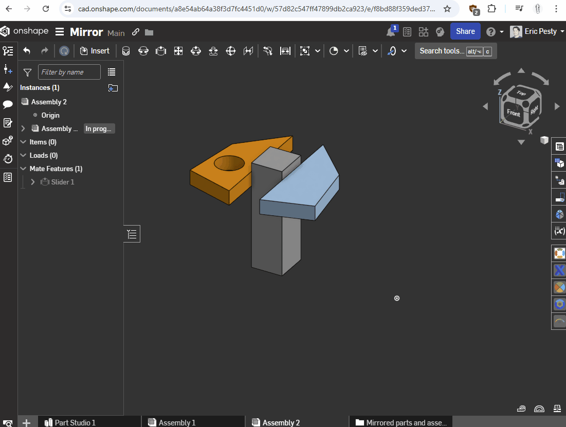

    Easy enough to add explicit MC to any of the main part CL (or directly in the assembly)… You can just create an implicit MC at the origin on the fly in any of the 3 axes so not sure what the big deal is…
    I don't work a lot with symmetric assemblies so this hasn't been a huge issue personally but it looks to be nicely implemented!
    Named section views in drawings are going to be a lot quicker to setup! Now we just need the ability to control the "regions" that are cut when using multiple section planes!
    Also pretty excited to not have to reload the whole render studio to change configuration!

  • eric_pesty
    I'm guessing you are talking about adding feature to the "original" part after it's been mirrored in the assembly but not propagating these to the mirrored part?
    I would think that making mirrored parts "different" should be a bit of an edge case.
    Might be easier to mirror the part in the part studio for these cases…
    Probably more applicable to assemblies, although here it looks like you can already suppress some of the mirrored items and add other ones in the mirror assembly so easy enough to create a "mostly mirrored" assembly!
    Just found an improvement opportunity: it's currently not possible to manually configure things in the mirrored assembly. So if you add an extra part and or suppress something from the source, you can't add that to the configurations.
    I can understand how adding configuration inputs in there would get messy but adding stuff to the exiting ones would provide even more flexibility!
