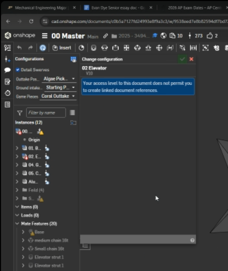

BUG? user with full access (even delete) getting access error

All he was trying to do was change the configuration of a subassembly.

    Looks like the configs are being driven from other documents and the user does not have link permissions to those documents?
