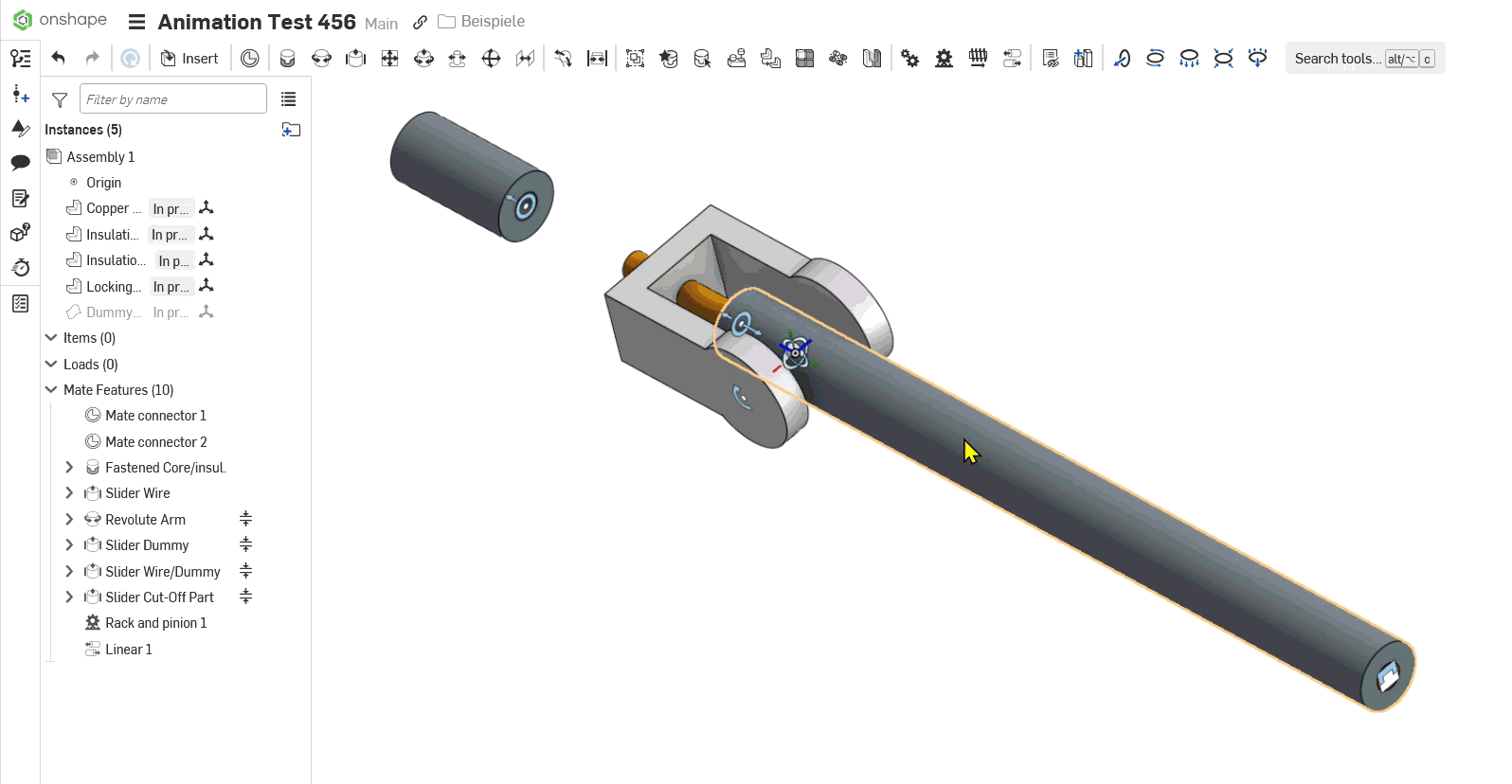

    That appears possible with a few sliders (with min/max limits), one dummy part that triggers the locking and maybe a gear mate to rotate the locking arms.
    Click on image to see it move. Not perfect, but maybe shows a possible approach.

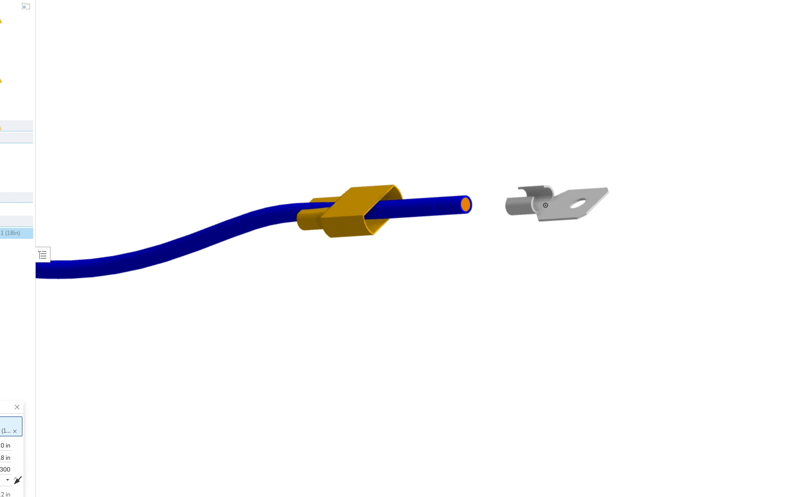

    @stuart_aspinall ..cross posting here. Here is another example of the 'art-of-the-possible"… this is accomplished using an Animation Timeline…. search for posts by John McClary and/or NeilCooke for more details.
  • martin_kopplow
    edited September 2025
    It is done by having one part (Wire) running into another part, pushing it away and then link that other part's movement to the movement of the third (locker arm) and fourth (cut off insulation). It is a chain that has some 'play' in it to take care of the necessary delays. I used a dummy part (flat face) for this, which is then hidden.

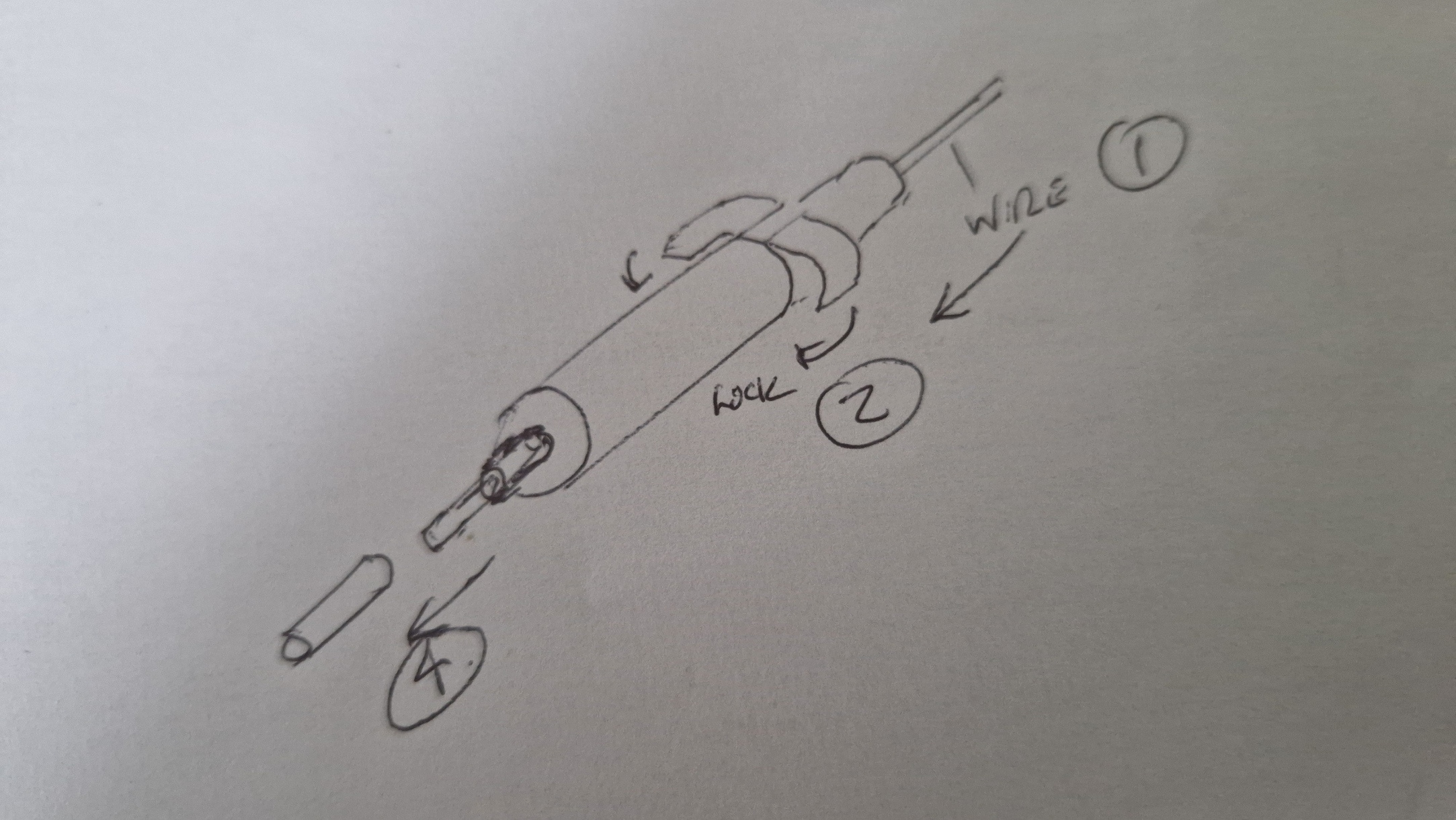

    Martin…Ive downloaded your assembly, and made a copy so I can look at the mates etc….could you just write a step by step of how you did it…like put in any stationary parts and fix them in place…then add the moving parts, with slider and or rotate constraints…then link the linear movement to make the rotation move slightly.
    What I want is the majority of the connector doesnt move and would be there initially, with the clamp arms open. Then step 1 is push wire all way through. Step 2 is lock the arms down. Step 4 (should have written 3,,,lol) is to remove some of the insulation. Ive attached a pic of the steps.
