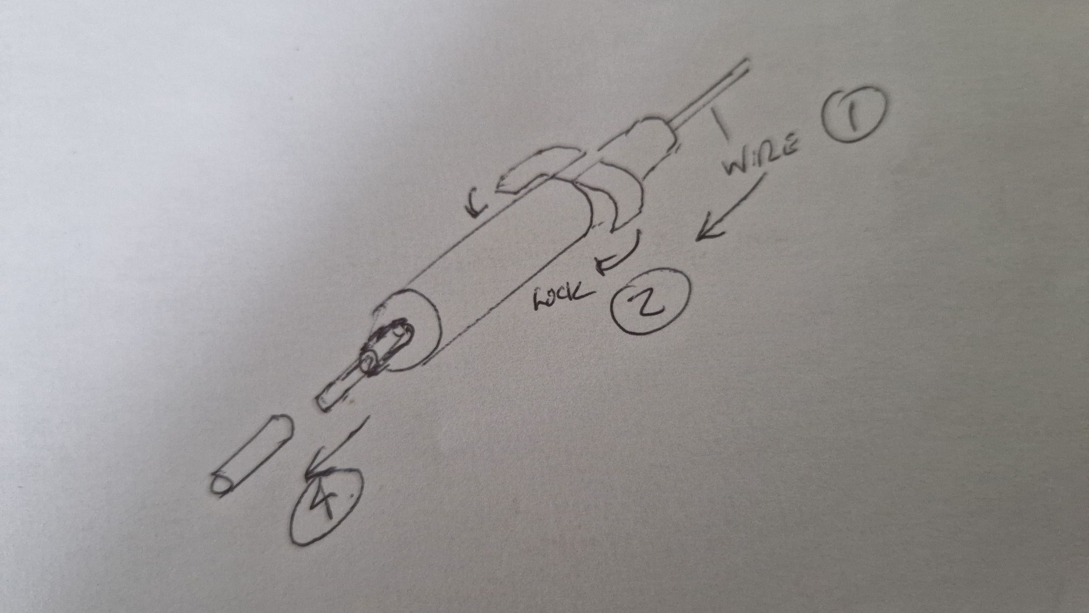

Hi, wanting to animate of how to assemble a connector….so wire pushes through a locking mechanism which then closes from being like 60 degrees open, back to 0, then the insulation is cut off to expose the wire, then a protective cap goes over the end to protect the wire. They are all cyclindrical and connect in a straight line, except for the locking mechanism arms which are at right angles to the main assemble but close around a pivot which is located above the central axis of the connector…..I cant show because it for a contract Im working on, and a patent on some of the parts currently is active.
Could possibly knock up a similar concept with some arbitary parts if needed to explain further. Its just ive only seen where you can animate 1 mate….apart from the robot animation principle where they use like a graph concept where parts follow different paths in the graph….but struggling to marry up that principle to my scenario.

    That appears possible with a few sliders (with min/max limits), one dummy part that triggers the locking and maybe a gear mate to rotate the locking arms.

    It is done by having one part (Wire) running into another part, pushing it away and then link that other part's movement to the movement of the third (locker arm) and fourth (cut off insulation). It is a chain that has some 'play' in it to take care of the necessary delays. I used a dummy part (flat face) for this, which is then hidden.

    Martin…Ive downloaded your assembly, and made a copy so I can look at the mates etc….could you just write a step by step of how you did it…like put in any stationary parts and fix them in place…then add the moving parts, with slider and or rotate constraints…then link the linear movement to make the rotation move slightly.
    What I want is the majority of the connector doesnt move and would be there initially, with the clamp arms open. Then step 1 is push wire all way through. Step 2 is lock the arms down. Step 4 (should have written 3,,,lol) is to remove some of the insulation. Ive attached a pic of the steps.
