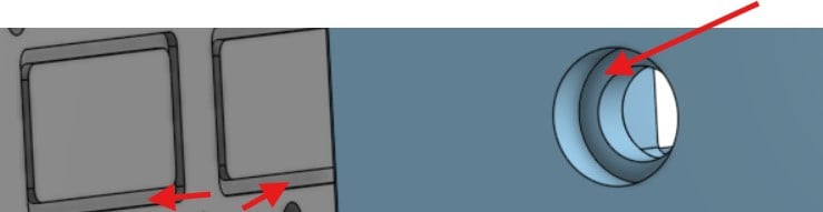

I am new to Onshape and CAD in general. I am using it mostly to create 3D printable models. I was wondering if there was a simple way to create Seals and Gaskets for my models or do I have to design them into my Part studio designs. Sorry if this doesnt make sense, and thanks in advance for any help.

    Assuming you want to print the seals as well (with TPU?), I would use the "thicken" feature (with the "new" option). Then maybe use a "move face" to create clearance if needed.
    If you want to use standard O-rings, then you have to size the feature to match the features so they work with available orings.

    Click the faces you're pointing at and just use the Extrude or Thicken features. If you're printing them in a multi-material print then you're done, otherwise do as Eric suggests and add clearances with Move Face.
