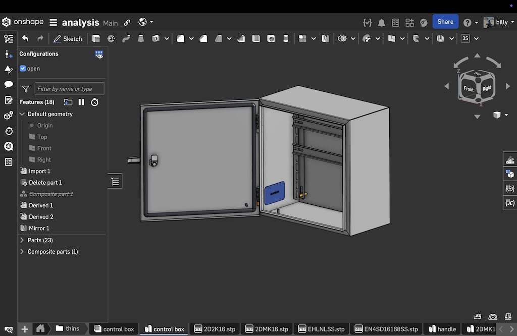

I just wanted to see an analysis with a sheetmetal part.
This is a Hoffman enclosure roughly 40cm x 40cm and 1.5mm thickness:

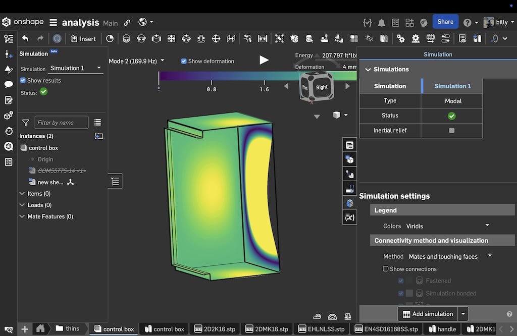

This didn't take long to solve. Below is the rear panel in resonance @ 170hz:
I think shell elements solve faster but it's harder to work in a mixed element environment dealing with tets with shells and having them connect properly to each other. I didn't have to declare anything as shell elements, it just did it The next test is to model a mixed thick/thin environment and watch how the strain is transferred between thick & thin parts. Not having to control 2 mesh types is huge.
Possibly analyze a piece of 80/20 with an "L" bracket bolted to it.

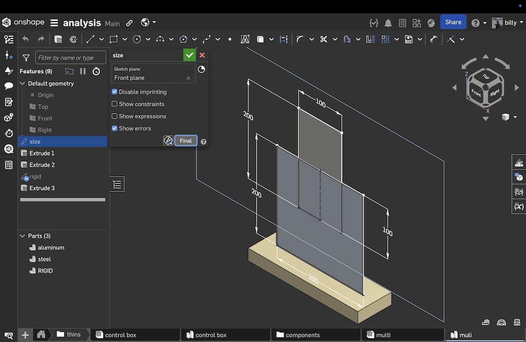

    Very simple test for "thins".
    So I magically bond steel to aluminum and then applied a 10N load to varying thins:

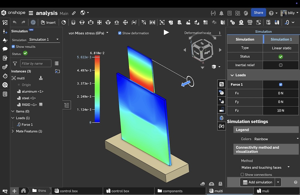

    To start the test I used 6mm for the aluminum and 4mm for the steel which solved quickly:

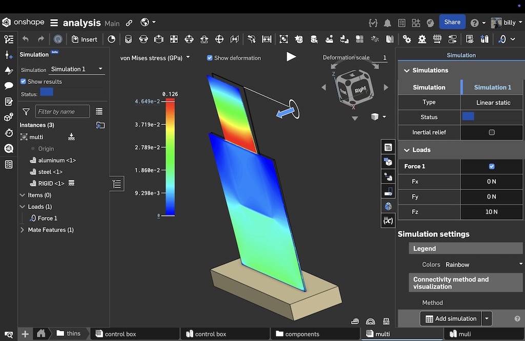

    Then, aluminum 2mm thick & steel 1mm thick:
    The 2nd status, what ever this is, it never finishes. I'm guessing it's re-meshing based on the strain levels from the 1st status run. I stopped it after 13 minutes.
    Possibly just add a stop compute button. I can live with the 1st set of results since the majority of my analysis are differential analysis techniques. Basically I'm just asking is this design better than the last one?
