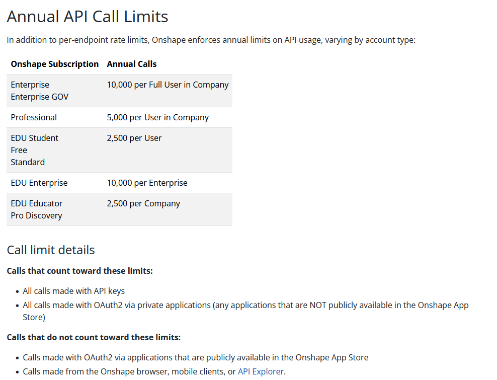

In case you missed it, Onshape updated their API Limits policy in the most recent update (October 10th, 2025). Onshape has always had an Annual API Call limit, but the exact amount was previously undocumented.
https://onshape-public.github.io/docs/auth/limits/
Unfortunately, it seems very hard to imagine developing and testing apps of any size while staying within these limits. It's also a major limitation for anyone wanting to use the API for any sort of personal tooling or automation. For example, I can no longer use the tool I have which updates my FeatureScripts to the latest std version for fear of running out of API calls.
  • On the EDU side, 2,500 requests spread evenly out across the year comes out to just 6.85 requests per day.
  • The limit is annual, so if you run out in January you're SOL for the rest of the year.
  • There's no documented way to see your current usage, so you have to track it yourself.
  • Although you can buy more requests, there isn't any transparency about pricing, and as an EDU user developing free tools for robotics teams, I'm frustrated by the prospect of having to start spend money just to maintain my existing development efforts.
Ultimately, it's very disappointing having to suddenly jump through hoops and re-architect major portions of my apps (or break out my credit card) just to meet these new, seemingly arbitrary requirements.

    API calls made by publicly visible apps in the Onshape App Store using OAuth2 credentials don't count towards the limits - that's documented on the screenshot you posted. If your Apps are of universal appeal and provide value to other others outside of your own personal context, you can work through https://onshape-public.github.io/docs/app-store/ to make the Apps public.
    For developers who are considering creating an App in our App Store, please get in touch (onshape-developer-relations@ptc.com) - you don't need to be limited by the posted API limits.
    If you are part of an EDU Enterprise (or other paid plan), you get access to higher API limits, with options to purchase more.

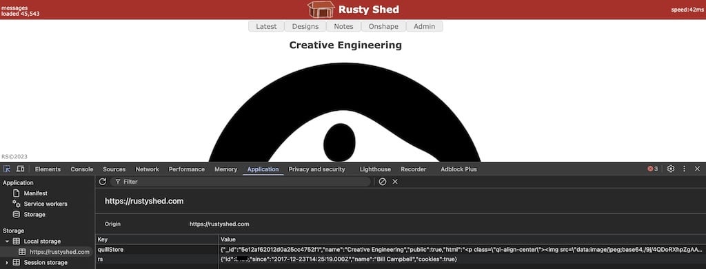

    @Konst_Sh I've been storing peoples stuff on their computers for awhile. When a client shows up, I establish a socket to my server. I can now store information in mongo or just put it in there browser, I chose their browser. It's now persistent, they can leave and when they come back I can show them the last state without contacting OS's api and building something to show.
    One thing about pinging OS all the time is you get fresh stuff all the time. I've been thinking about the data state on OS and has anyone made any changes to data I'm interested in? You could register an event with OS and have them notify you (or your server, because it's always listening) and get a fresh set of data only when it's changed.
    I don't know how many event handlers OS is willing to let me generate nor can I setup an event handler that detects a specific data change that I'm interested in. I don't know if I could get OS to behave and give me a notice when there's been a change to the data I'm interested in.
