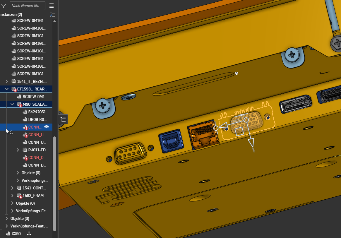

Hi,
is there a possibility to supress the erros in importet parts?
We often have the problem that electric connectors have import errors. We only need the geometry of the connector but not the full detail of the connector. But it's annoying that the whole assembly is marked with an error. Therefore it would be nice to supress the error in an imported part.
I could draw a dummi of the connectors but it woudl be more time saving if I can just supress the error.
  • S1monS1mon Member Posts: 4,077 PRO
    I would like this too. It's also really funny because one of the things I had issues with recently was also an import from Elo.
    I would caution you though. Typically when there's an error on a connector like this, you end up with a surface instead of a solid. That could be fine if you just need a visual representation, but if you need to do any kind of interference checking, it's a problem.
    edited October 2025
    I want this also. There's a lot of crap out in the world and it bugs me that OS throws an error that I can't clear.
