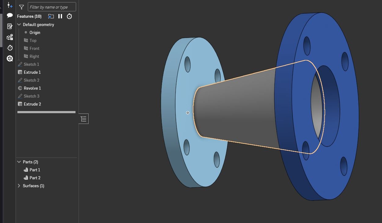

I don't know what I got wrong while I was drawing and issuing the revolve command, but I ended up with these parts:
It apparently looks a bit different than it is supposed to be according this tutorial

In particular, I ended up with more parts and a surfaces, also the revolved object has a different color.

    Looks like you need to select add in the feature. Should be able to select merge all.

    I eventually realized that it was not the only problem with the sketch, that is, the lower part of it ended up on the hole not on the object, so it didn't merge. I didn't know that. However, what if I would like to make it merge anyway?
    Thanks
    So long as the parts are in contact or over lapped they should merge.
    If the parts dont over lap but the general form is correct the you could use a move face or replace face to bring them together for a Boolean.
