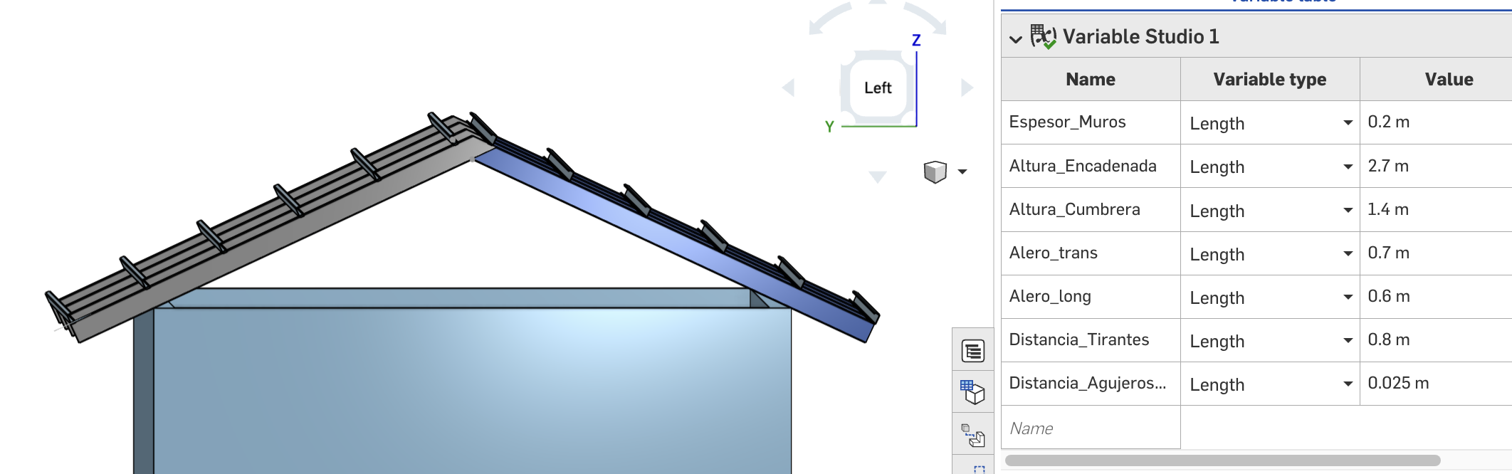

Hello. I'm trying to assemble a "parametric" roof for a building. In the Variable Studio there are several variables that should control the roof geometry.
https://cad.onshape.com/documents/643a1121577ac78a29dd0031/w/9cb5e51501a7232ed26e0997/e/5be2ef5f792e3d21630803b5?renderMode=0&rightPanel=variableTablePanel&uiState=68f4bf86dce4e338d841f719
Please have a look at what happens to the "Tirantes" in the left half of the roof when you modify the parametric variable "Altura_Cumbrera".
The next photo shows the intended result (all Tirantes on top of their Cabreadas with de C opeining facing up), with Altura_Cumbrera = 1.4 mts.

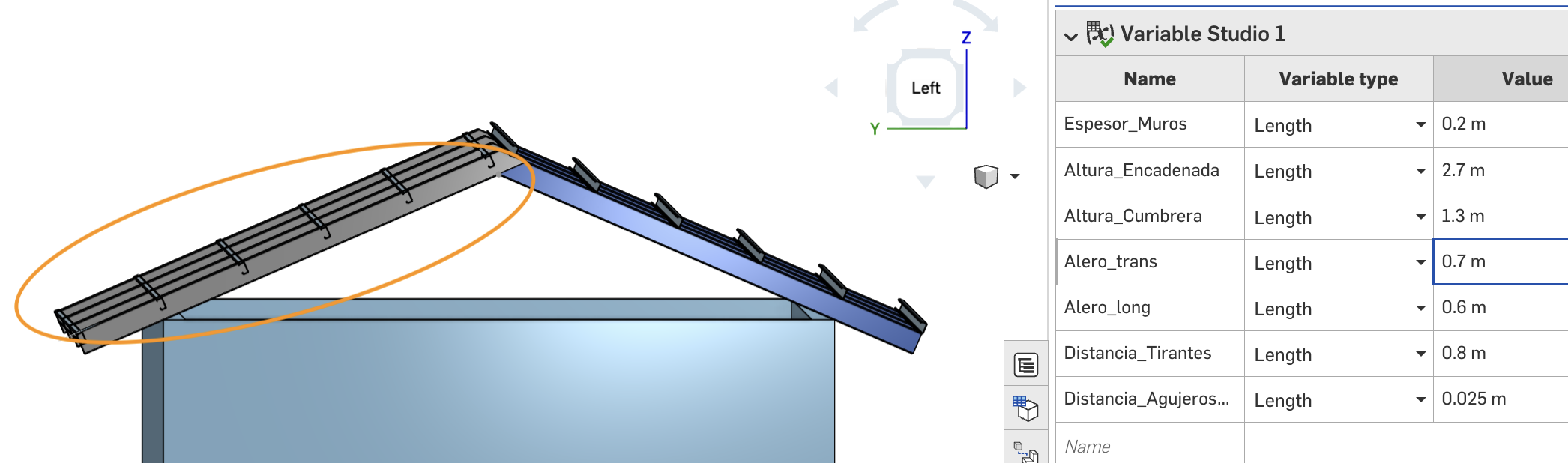

But, when you change Altura_Cumbrera to something like, say, 1.3 mts. all the tirantes in that half are rotated 180 deg and buried into the Cabreadas. The misorientation affects the lower Tirante, and then copied to the rest by the Replication tool.
For different values of Altura_ Cumbrera the situation toggles between one state or the other with no evidence of any logic.

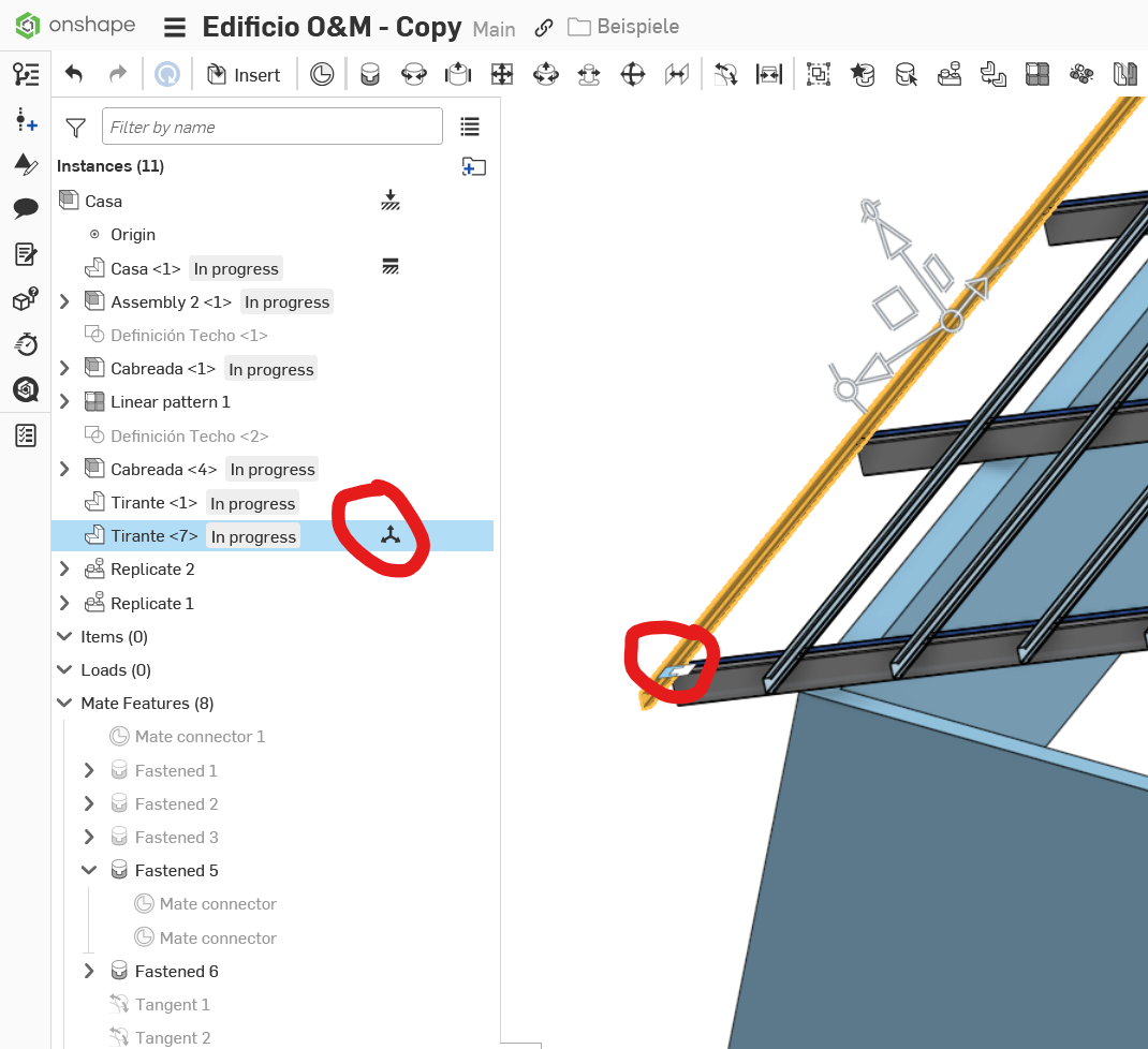

This has something to do with the "Fastened 5" Mate Connector, which I've left visible intentionally, the one that mates de lower Tirante to the Cabreada. I CAN correct the rotation by messing around with the mate connector axes and their orientation. But the upon changing Altura_Cumbrera again the orientation "bug" continues just in the opposite state upon the different values of Altura_Cumbrera. You can see that "Altura_Cumbrera" takes effect in the sketch that defines the profile of the roof in the early part of the flow.

    It appears strange, that only this one Tirante <7> has degrees of freedom.
    It clearly makes use of them at some point. The other parts are mated to the Tirante via the Cabreada, but not to the house, and so they may also move in an unexpected manner, even it that happens in almost unrecognizeable steps (you can grab the roof and move it sideways, for example). I have the suspicion that the sequence of mates is not starting from the right point and that the general position of the roof on the walls needs to be defined first (like Cabreadas always having contact with wall edge and the roof sitting somewhat symmetrically on the house). Only then can reliable dependencies be built.
