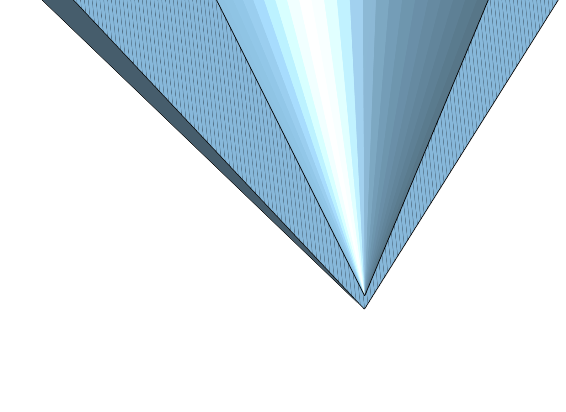

When I tried to revolve this triangle around the vertical line, I get the revolve error in the title, and I have no idea why. Could I get some help with this?
  • martin_kopplowmartin_kopplow Member Posts: 1,103 PRO
    Yepp. The tip is the critical point. You couln't build such a volume in real world either.

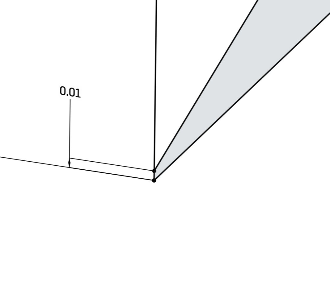

    Here is one solution….
    https://cad.onshape.com/documents/2fb0d55347a49b9a52480126/w/fdb10e0eabca668190cfe793/e/9d1e92fdf7a197c5e1688f4c
