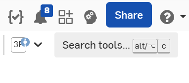

  • robert_scott_jr_robert_scott_jr_ Member Posts: 743 ✭✭✭
    Here is one resource. Have fun. Perusing the site is intriguing.
    There is a search tool within a document
