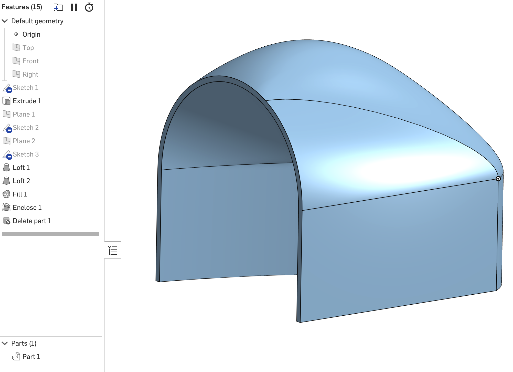

Hey out there,
I am trying to generate a loft between two surfaces. The magenta lines show pretty much exactly what I want, but there is just one more error I am unable to figure out.
Could you point me in the wright direction ?
https://cad.onshape.com/documents/215da0f935a788b83515cfa9/w/c8239880181b11774664bc4d/e/5c0a15635bc4f7448c2db75b?renderMode=0&uiState=691cf81c89a50ba7076fa47a
When solids don't work, I often revert to surfaces.
Here's a quick stab. Not the prettiest contour, but it works.
https://cad.onshape.com/documents/b58bd9d43441dc213edca7b4/w/c023bdb0701dbebaac326c93/e/b24333e36f9d3a529524387f
You can tell in the magenta profiles, that the loft is 'rotating' about an axis within it's own geometry, So it's creating self intersecting geometry here:
and like matt said: best too thicken later in the tree.
