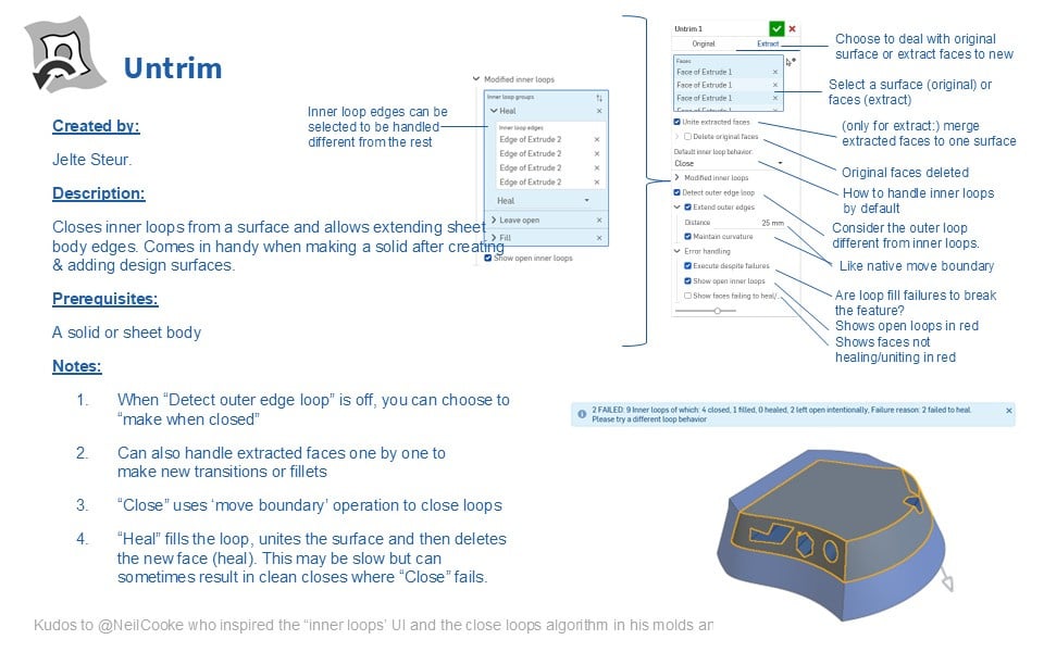

I've recently created a model with quite some surfacing work that in the end needed to merge to the solid.
Often when surfaces are created, there are gaps at some ends of the surfaces that need to be healed/closed/patched.
I've found quite some additional use cases, bugs and improvements for my original feature and have implemented them. So I feel the feature deserves some new attention:

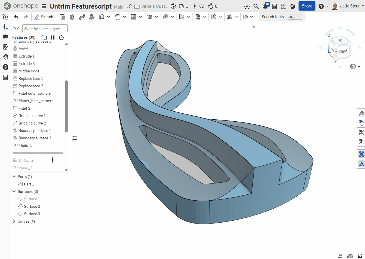

Original untrim to patch holes
Here's a demonstration of how 2 merged surfaces left 4 gaps to be filled and untrim does it in one go, and creates a solid part with the original properties/id.
Most importantly, if the nr of gaps or edges in a gap change, it'll continue to close.

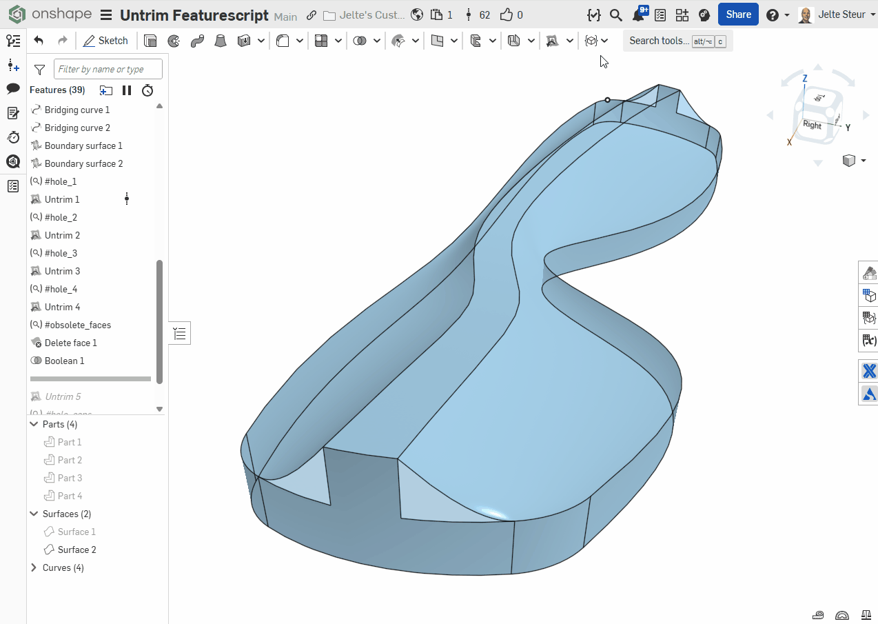

Extract untrim to extract holes
Here's a special use case to extract a hole from a part, and make it into a solid: (Internally, it extracts the faces, fills the loops, deletes (set to heal) the original faces). In this case the hole will be increased in height and removed again from the part later when some surfacing has been implemented.
