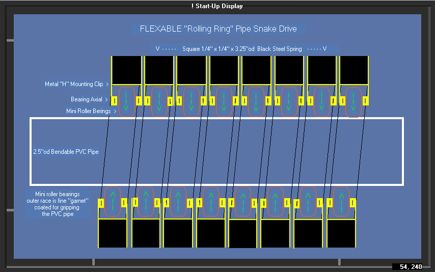

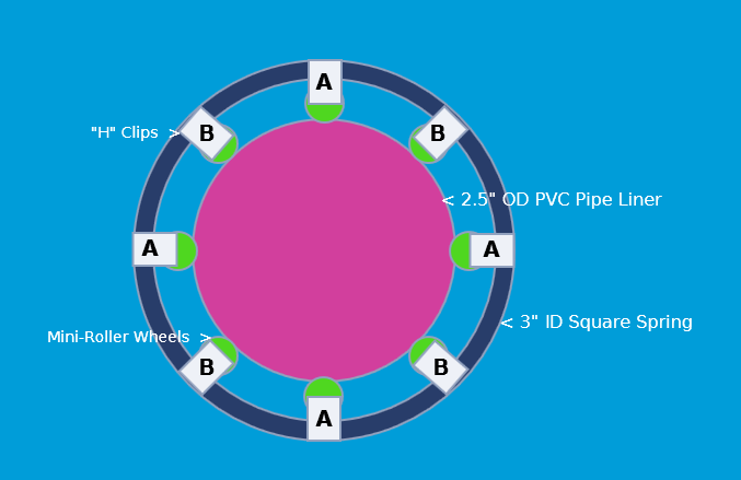

I need to construct a round double helix spring (with 0 and 160 degree starting points between these two springs).
The spring is 1/4" x 1/4" square wire construction, 3.5" OD x 10 ft. long (only the wire used to make the round helix spring is square).
For real world project ref: (see attached pic)

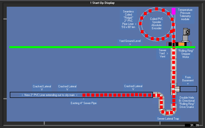

This spring (think: sewer snake) is incerted down the sewer yard vent pipe from yard level straight down to the sewer trap then negotiates thru and around the "U" turn and the following 90 degree turn then ends there.
When this spring is rotated it forms an "articulated rolling ring drive" pulling the PVC repair liner down into the damaged sewer lateral all the way out to the city sewer main.
In onshape, I wish to display just this spring in its fully incerted position (straight run section + U-bend + and 90 degree bend) and to have its rotation animated (spinning) realistically throughout its entire spring length (think: a long necked letter "J" with a 90 leg)
